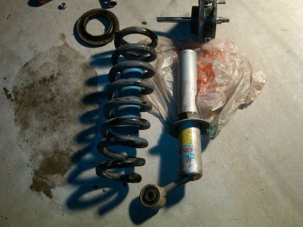

    without getting too technical, a spacer lift makes the suspension bottom out before the stock bump stops, so a hard hit would bottom out the shocks metal to metal, either blowing them, or snapping the rod ends as show. :thumbsup:
