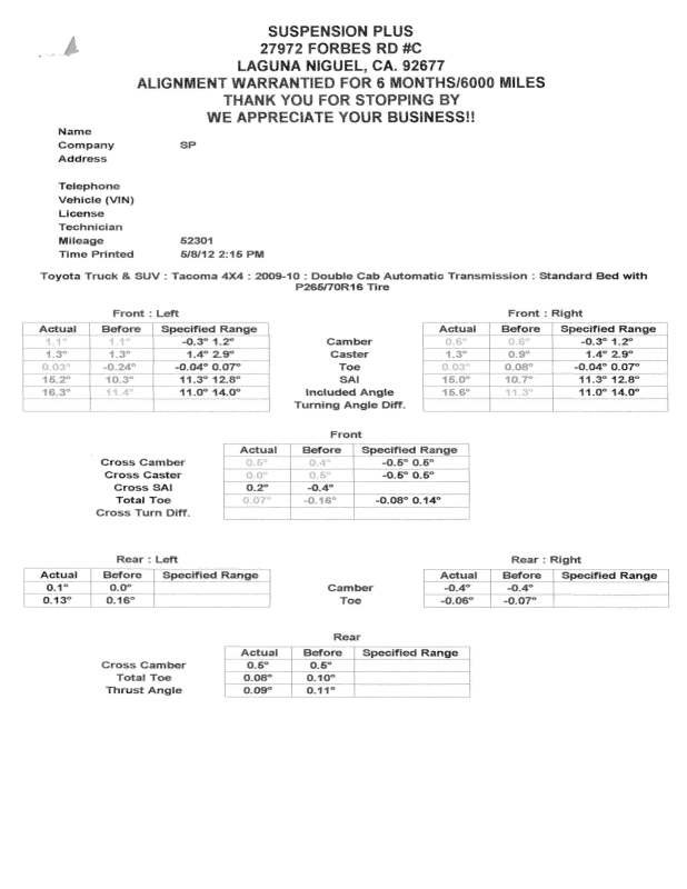

    Here is my sheet. It's a bit hard to read, but here are the camber readings.
    Front Left: Actual 1.1*, Before 1.1*
    Front Right: Actual 0.6*, Before 0.6*

    No change before/after in left camber or caster. You'd like less camber there and more caster.
    At the right wheel you came out OK, sorta.
    For both left and right, it'd be nice to trade off to get a little less camber and a little more caster - truck would driver better.
