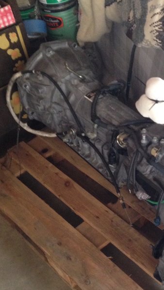

  3. Feb 28, 2017 at 7:00 PM
    Steelhead Huntah

  4. Feb 28, 2017 at 7:02 PM

    I also think the 03-04 is electronically controlled do to the drive by wire throttle. The earlier ones with a throttle cable only had a kickdown cable going to the trans. Someone correct me if I'm wrong.

    Does this one have a drive by wire on it? That long wire on the side of the tranny? I really hope it isn't because I need it for my 2000 and it doesn't use the wire

    Looks like the actual shifter cable to me. I haven't actually pulled one of these from a Taco to know for sure though. The same tranny is used in lots of vehicles..

    I looked around on Google images and it looks like all the transmissions pulled from 4Runners have this cable (this one is off a 4Runner). It has the normal shifting linkage it's just hard to see in the pic. I'm thinking it's like for the speed sensor or something?
