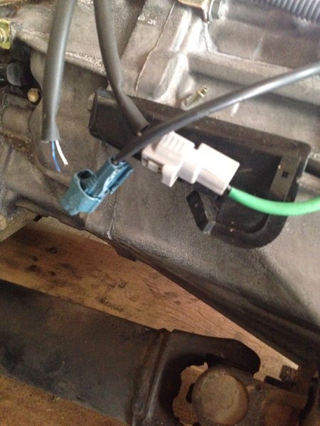

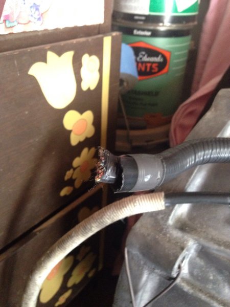

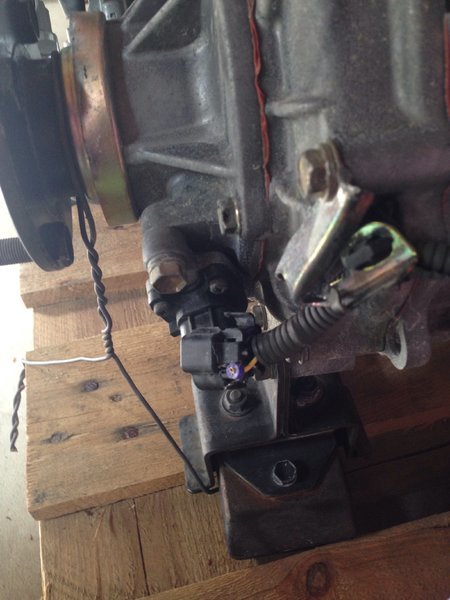

    Ok so I'm gonna sound like a total newb (which I am but hey learning as I go) but I need to know what all these wires are on my transmission. They're all clustered into a long thick black mass of wires that whoever took the tranny out cut

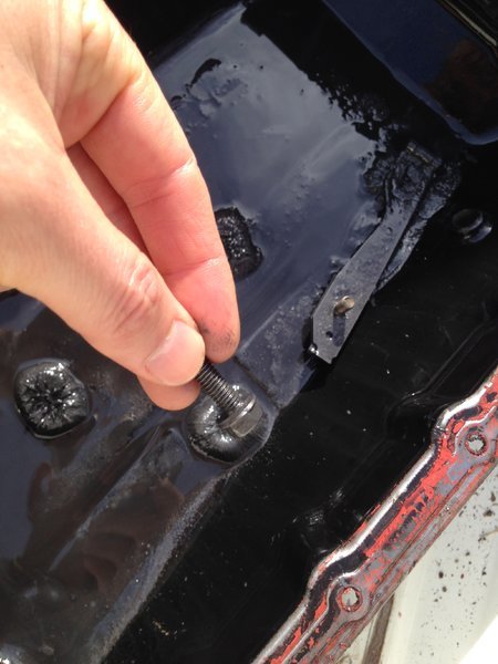

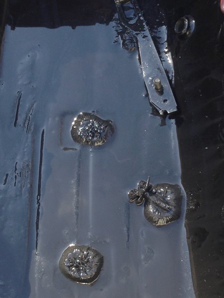

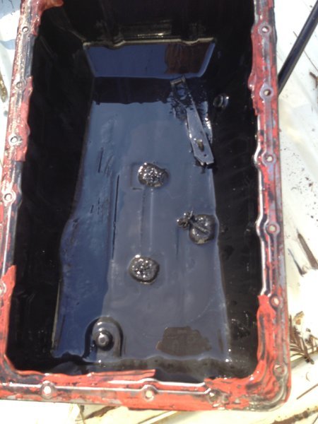

    Pulled the transmission pan from my truck, still working on getting replacement and removing old tranny. But this is what I found in pan. Looks like one bolt and some kind of extension part?? But not good!!

    That is the detent spring for your manual valve .

    Considering what I see laying in the pan , try bolting the detent spring back up and take your truck for a ride . With that spring outta place , there would have been cross leaks in the pressurized oil flow and the transmission wouldn't know what gear it was in .
    Not sure if the metallic sound you were hearing will be gone ,but might be worth a try unless you are far beyond this step by now
    I am more concerned with the chunk of what looks to be a roll pin laying on your center magnet . Clean that up and try to determine what it is

    Looks like size 10 bolt??
