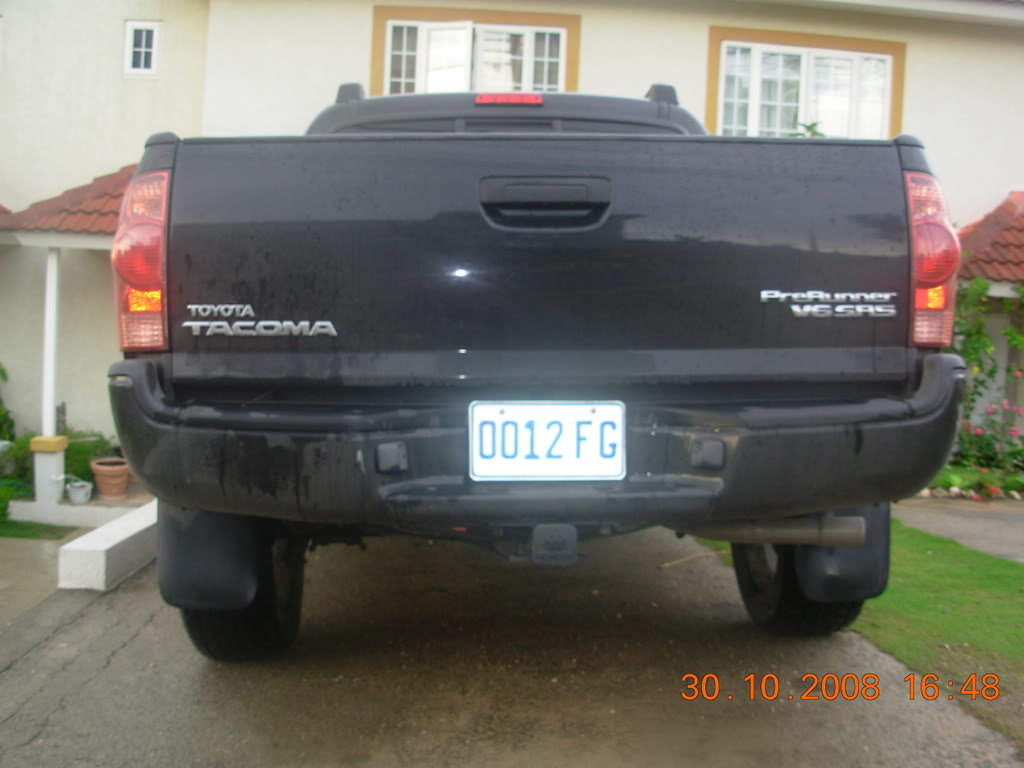

    I did mine, also took out a few dents. The guy at the bodyshop said he sanded it down, then applied a special primer and then painted it. You could probably just ask a paint shop about what primer to use, I think that is key.
    Over two years now and it still looks good. No stripping or flaking.
