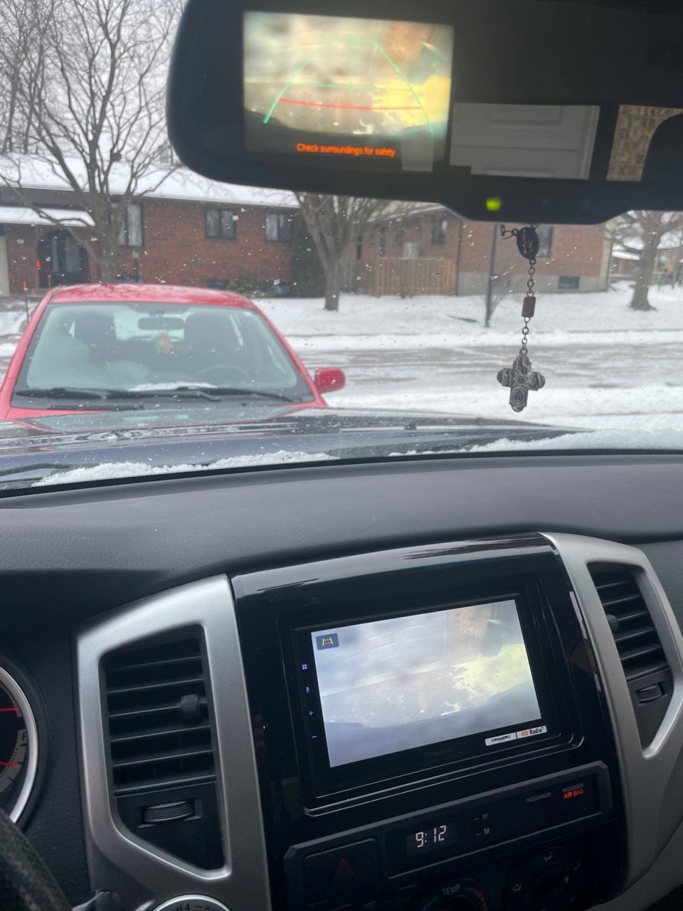

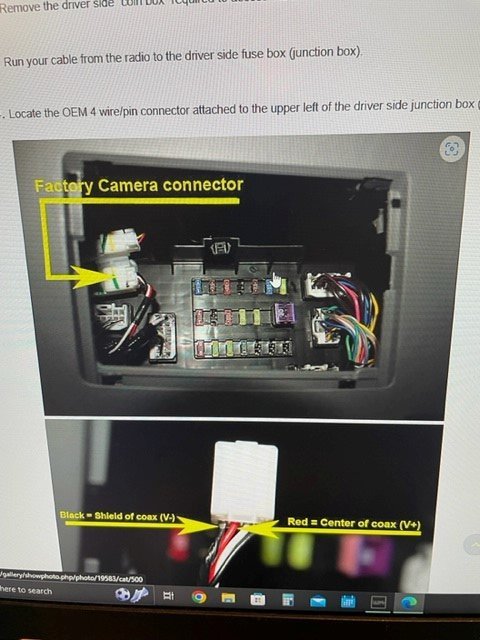

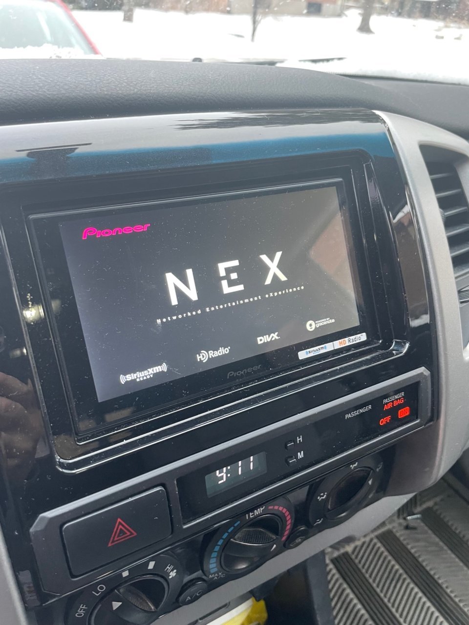

    for the usb part....I used this from Amazon. and here is my install.
    do yourself a favor , get a single RCA, connect it in back of radio and cut off other end and connect it here. well worth it.

    A fuse box behind the head unit? How convenient, thanks Toyota.

    the picture I put of the fuse box is on the left side of steering
