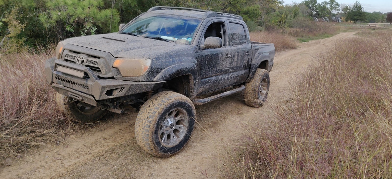

Anybody happen to be at Dirty South Park in Houston Today? That Tacoma that sunk was me, lol

    I didn't think Dirty South allowed trucks anymore but they do! It's huge and bad azz! Abviously I don't have the video on my phone a friend is going to send it to me to share.
    Need some opinions here for the night. We got it out. No hydrolock runs great. Water was above our kees in the cab. Took a good 10-15 minutes to pull it out.
    We are staying here tonight, it's 80% humidity outside 30% chance of rain.
    Should I leave it closed up, leave windows down and cross fingers or let it idle all night with heat and AC on full blast?
    Head lights work, dash cluster works, brake lights are constant on if truck is running.
    Any ideas on brake light issue to get it home?
    All in all great time! Awesome park you can pretty much see water line here

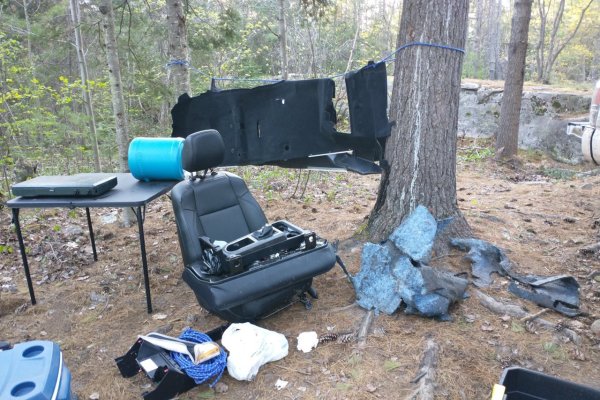

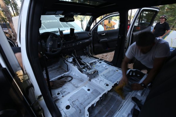

    The pile-foam underpad under the carpet will never dry out and is basically trash. My suggestion if you have tools:
    Remove seats
    Remove center console and other plastic trim
    Remove carpet and throw in bed - it can be washed when you get home and hung dry.
    Remove underpad and throw in bed - it goes in the trash when you get home.
    Reinstall seats, center console and other plastic trim onto the bare metal floors so you can drive home.
    One guy in my off-road club got swamped and we pulled his interior at camp:
    Brake light issue may be waterlogged switch above the brake pedal.
    Your engine air filter is probably covered in mud and should be replaced.
    Install some waterproof insulation under the carpet when you get home, like Noico or Dynamat.

    Pulled up as much carpet as we could and wedged wood under the pads with some blowing under pads dried more than I thought. Drove it friends house about 20 miles away this morning. Only error codes I got were something about an automatic transmission solonoid. borrowing the garage to do some more drying them hopefully get it the couple hundred miles home
    One issue is the REAR BRAKE lights stay on anytime the truck is started. Any quick thoughts on where to start to track down that issue?

    Thanks, I'll check brake switch, I have extra starters at the shop, good idea! I have dynamat, I use it for the roof and back wall, I never did the floor because I thought if I sunk it there would be no way to dry up the water under the dynamat on the floor?

    Speaking of starters?? This morning I turn the key and CLICK, that's it, like dead battery. Anyone ever have a starter totally lockup like that?

    Quick update, next day it wouldn't start had to bang the starter and jump using a big diesel truck to poo it over. Drove her 218 miles home to my shop. Kept getting a P0705 Code on charge and was running super high RPM's in 'D'. Pulled over at an exit, put it in L and launched it manually shifting up and it quit throwing the code. Pulled the interior it's dried out, guess I'll do yet another how-to on cleaning your OEM seat covers. Sub amp is toast, mid amp is toast highs amp is toast, active x-over is toast. Had extra amps at the shop, no x-over though . changed the starter. All in all, pretty damn fun trip! Going back soon!
    Oh, I also had to pull out the speaker box, I'll measure it and post specs on how we got over 3cu behind the seat of a Tacoma
