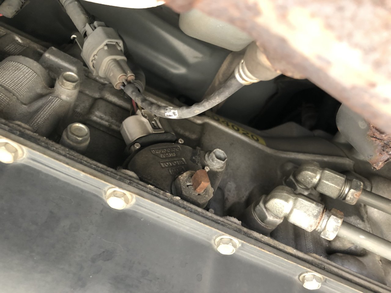

    Under the truck bolted to the transmission is the range sensor.
    The weather pack seal is known to go bad in them and cause corrosion and throw a p0705
    Unplug it and clean it out good, Use some electrical contact cleaner. Then a a LIGHT coat of dielectric grease on the seal. Don't put it on the contacts.
    The grease is nonconductive, and the pins are small. you don't want the grease prohibiting the flow of electricity, on the already small pins. Just grease the weather pack seal.

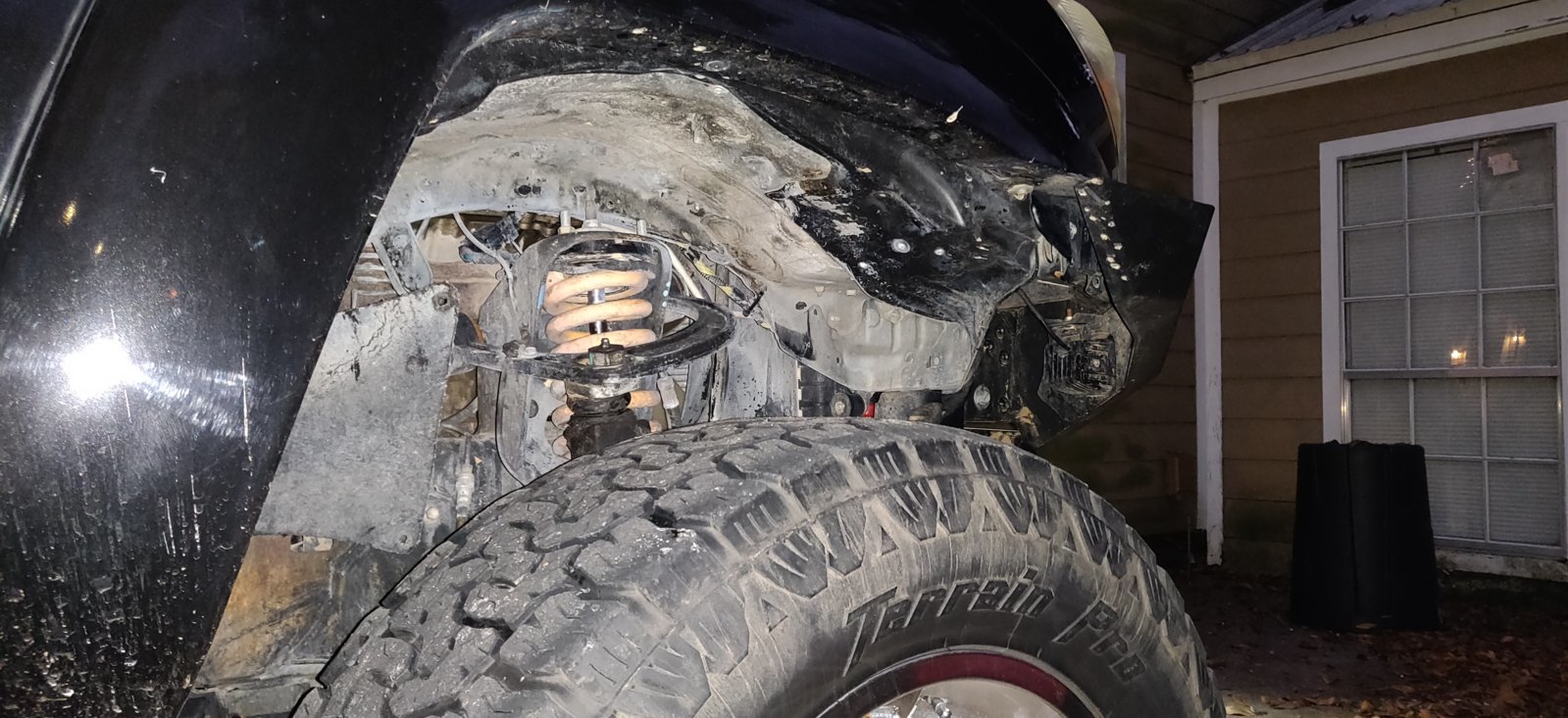

    It looks like you lucked out here, reviewing the video carefully you can see that both on the initial dive and the subsequent settling, the drivers side wheel was at least 6-8" or more lower than pax side, canting the vehicle towards the driver side, which lifted the passenger-side fender air intake an equal distance higher on the other side.
    If it had been a straight-in immersion with no lateral tilt the intake would have been far more likely to suck in tons of water & hydrolock the engine. Close call!

    I was watching the water line and killed the engine when it got close. But, yah I did get lucky. When I put the new bumper I cut the plastic fender liner so that I could screw it to the body and close it off from water coming through the front.

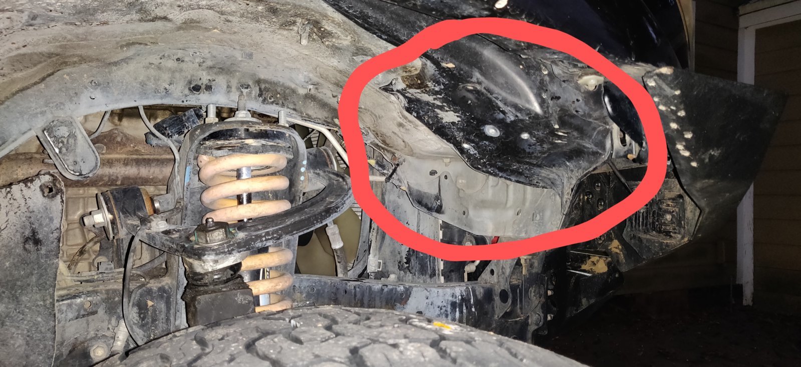

    This is most likely what saved me. Normally the fender liner is open in the front. I cut the liner and screwed it to the body so no water can get pushed up the fender liner into my intake

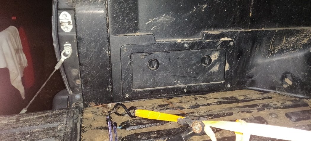

    Think the built in inverter fried, lights on the button don't even come on. Fuse and relay under the hood both look good.
