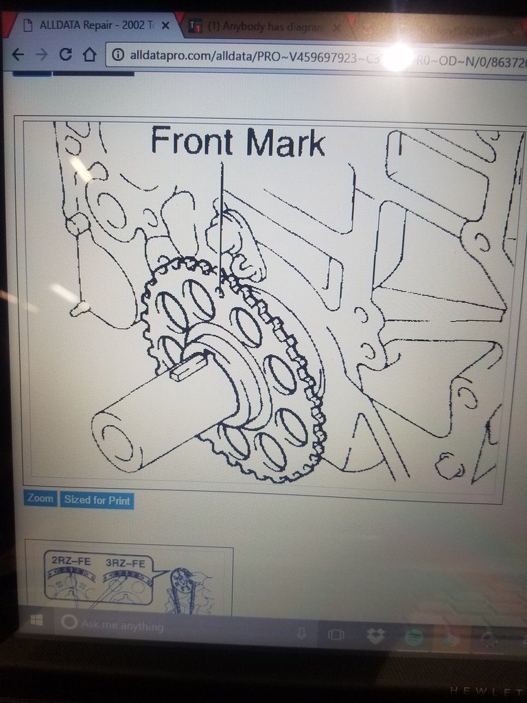

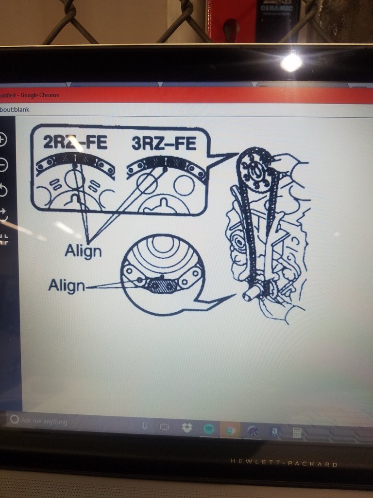

Anybody has diagram for lining up timing chain on 3rz? Dont feel like buying $200 fsm

    im in the middle helping my uncle 02 pre runner 2.7 change timing chain but he got hurt and went to ER,i just want to finish it and get it running
    Was thinking to buy fem but they were like $170 while chilton or haynes suck at pictures
    Any help would be appreciated

    give me a second

    First and last pic dont work,can you please repost or send to my phone if u dont mind 5018379922 thanks man

    sending to you now
