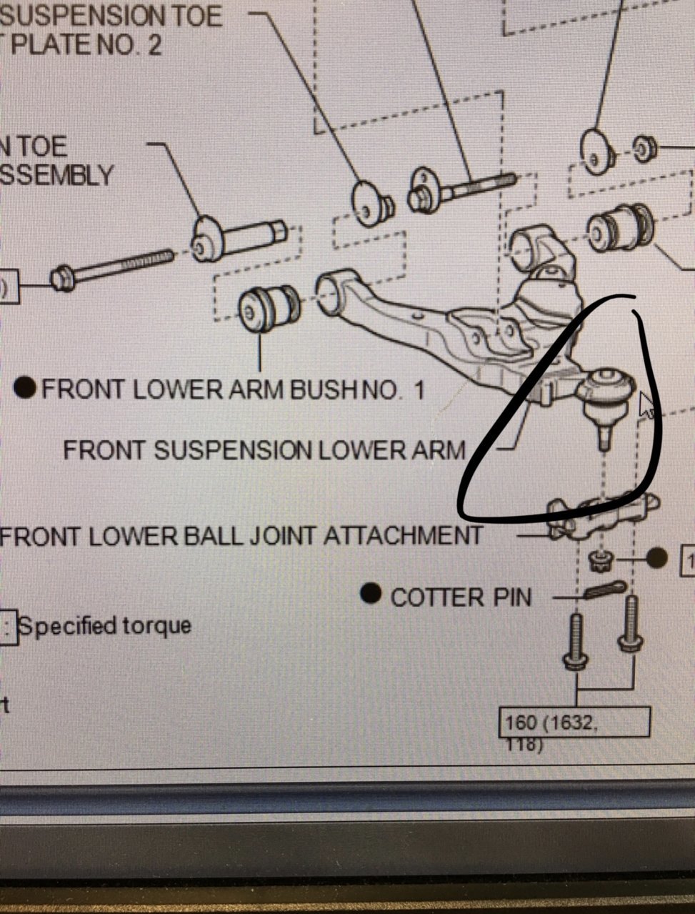

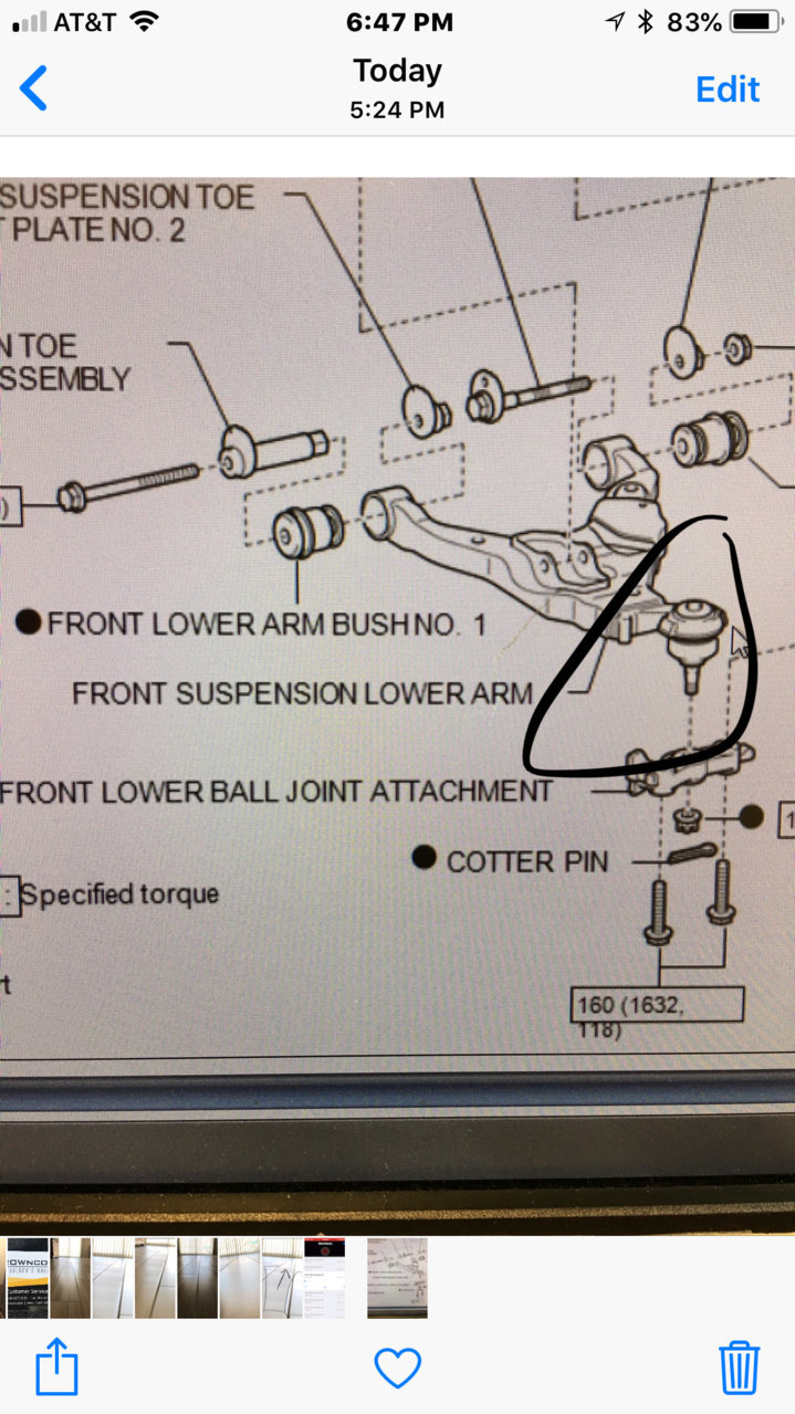

    No bro it is this
    Front lower control arm. The ball joint in that arm is where the snap ring is.

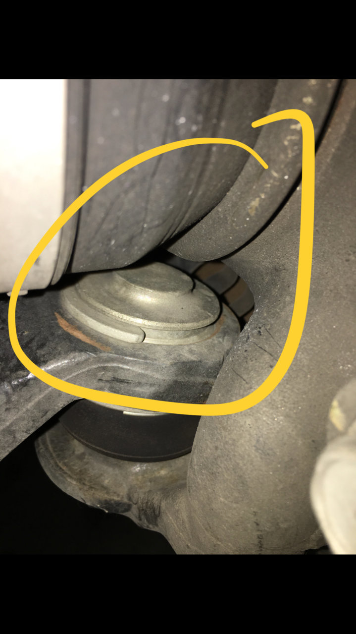

  8. Aug 6, 2018 at 6:48 PM
    #48
    djgynee
    djgynee [OP] Well-Known Member
    Jun 17, 2018
    #256633
    740
    Southern California
    2018 Magnetic Grey Metallic Tacoma DCLB TRD Sport
    It’s a C shaped snap ring inside that circled area but the pic doesn’t really show it

  12. Aug 8, 2018 at 12:23 PM
    #52
    djgynee
    Jun 17, 2018
    #256633
    740
    Southern California
    57BDCAA7-2549-467A-A616-D3373E858ACC.jpg This isn’t my truck but this is a pic of the exact part that was making a “chain or keys “ rattling sound. It’s called a snap ring. Sorry about the wrong name earlier

    Looks like the ball joint retaining ring. If that fell off all kinds of fun would take place. Toyota doesn't use Truarc rings?
