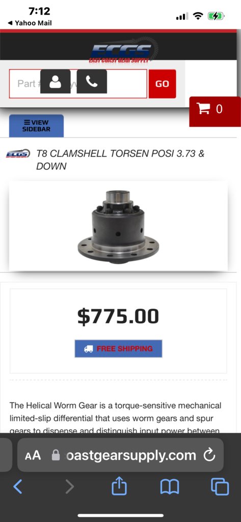

    that is true but not how nitro worm gear like the true track is now available i have a 2005 4x4 clamshell front ,no true track ? be waiting for 15 years ! the only problem no lower than 373 gear. i have a manual witch came with 411 so i had to change gears . autos have 373

    I’ve got this works great
