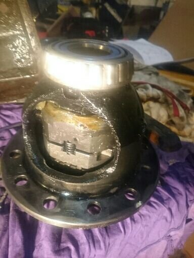

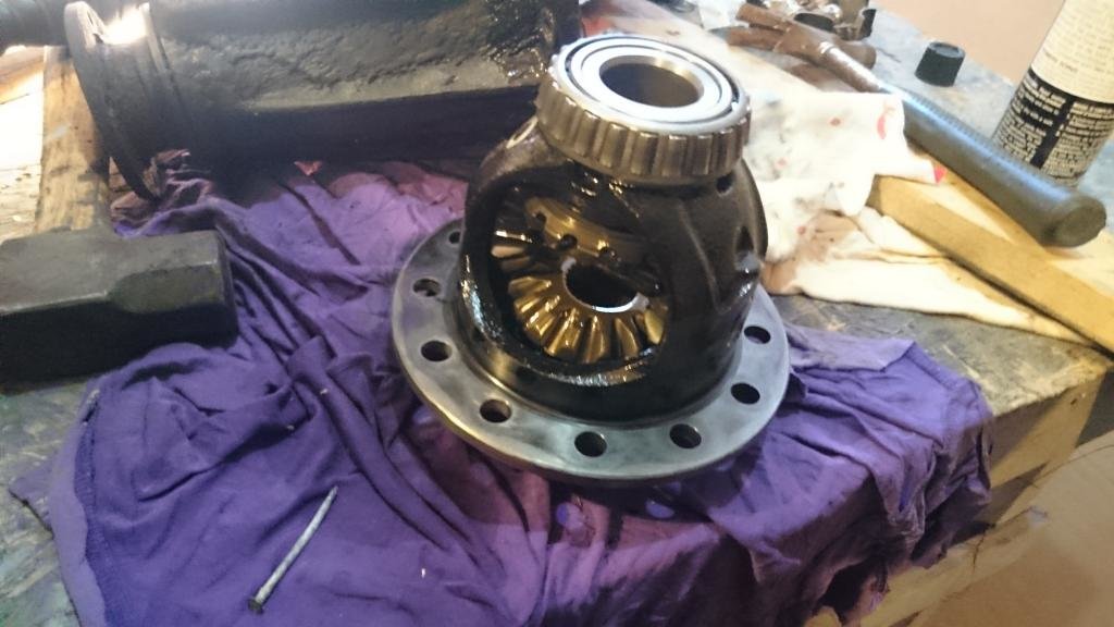

    Did you have to pull the carrier and unbolt the ring gear?
    That's what's kept me from getting a LockRight.

    ring gear has to come off to get cross shaft out. just mark it and put back on in same spot. nothing a brass punch and hammer cant do. used a 4x4 peice of wood to get back on slowly working ir around. 765bf6c0-2b99-4f2b-b14a-d7e49596f3f6_zps_80cdff328a0f2a0cb1dce22c2c63603fe17d9209.jpg
