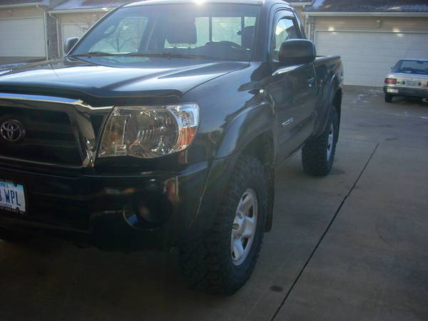

    I currently have 265/70/17 Duratrac's on my 08 AC and I do not rub at all. I have pictures in my profile if you're interested in checking it out.
    I don't have any type of lift or anything and no problems at all.

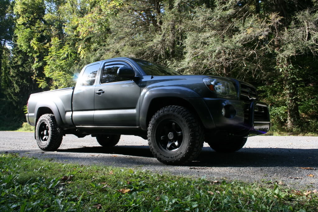

    I'm a stocker running 265/75/16 Duratracs. Check my sig below for pic. No rubbing issues at all, granted I removed all mud flaps.
