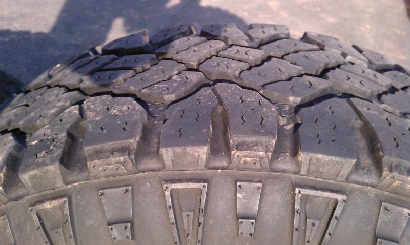

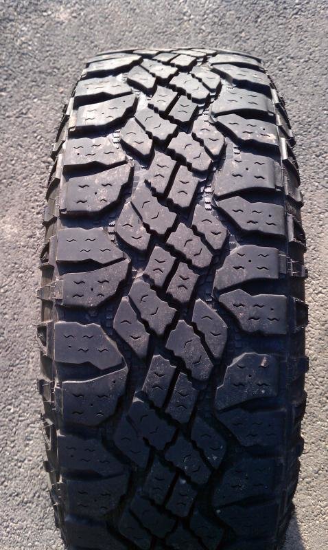

    Hey guys! First time posting, somewhat of a long time follower here. I’ve done some searching here and other forums, but I’d like to get your opinions. I have been running these Duratracs 265/75 16’s load C for about 4 years now with 40k on them. I love these tires! The treads are still decent after all the mileage too. No problems until recently. I rotated my tires about a month ago. Before that, it had been awhile. What prompted the rotation, besides it had been awhile, is that two of my tires became really, really noisy. The other two have no noise at all. Also, a lot of vibration associated with the two noisy tires (now on the back). So, do you guys think that in time the wear/noise will even out? Should I balance them again, and maybe a realignment? Is it a cupping issue? Or is it just time to get a new set? To top it off, one of the rear tires is currently flat (happened last night). No sign of a hole, puncture, cut, etc. either. But that’s another issue.
    Sorry for the long post. I’d appreciate any input!

    The two that were on the front are most likely cupped. The cupping could be caused by worn out shocks or bad alignment, or you could have just waited too long to rotate them. The front always wear harder than the rears, which is why you want to rotate so frequently.
    Balance isn't going to help the wear/noise. Now that they're on the rear, they will probably even back out a little bit, but once tires go down that road, they never come back to normal. As far as being time for a new set, that just depends on how worn they are. Post a picture?

    That's what I was hoping for...to re-balance out a bit by switching them to the back. I can snag a photo when I get home. I honestly don't think the treads are all that bad.

    Here are a few photos. I actually had my timeline messed up. I've had them for 2 1/2 years, but still the 40k on them, surprisingly. These are the tires in question. Rolling them across the drive way they definitely wobble a lot and seem to have an uneven surface all across.

    The flat tire I have might be damaged. It's pretty warped on the side walls. Looks like I might have to invest in at least two new tires, but with 40k on them, maybe just do all four.
