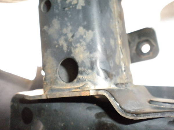

    I've noticed that you are coming up short on anyone sending you picks of their bracket/installation photos for their light bars. I think there might be an option that you could check out the next time your poking around under your truck. I noticed that there could be a possible mounting location on the the frame rails that attach to the bumper support bar (The bar that runs left to right inside our lower plastic valance.) I have included photos of their location. The foreseeable benefit of this location is the fact that no drilling would be involved, and there are two holes that would provide for lock nut and washer support on the mounting bolt and bracket.
    Frame Mounted Bumper Support - Exterior View

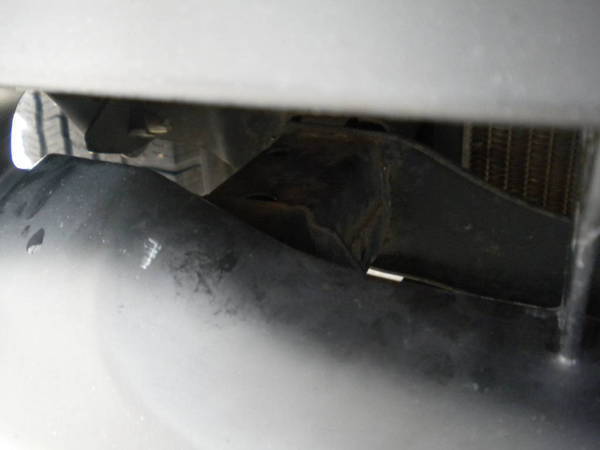

    The forseeable downside is that the location directly above these mounting points, where you would exit the lower valance, is approximatley 1 1/2 inches wide.
    Frame Mounted Bumper Support - Side View
    The holes located on top of the bumper support mounting points are aproximately 29 3/4 inches apart from center to center between the left and right supports.

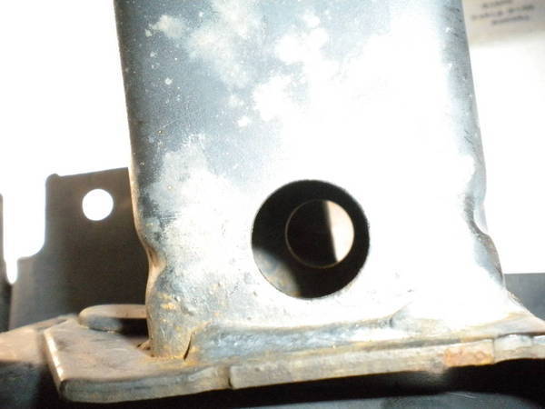

    Frame Mounted Bumper Support - Top View

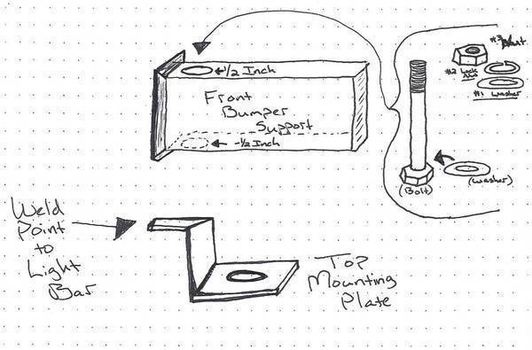

    The top hole measures a little greater than 1/2 inch, and the bottom hole a little smaller.
    Mounting Hardware Option
    If you made the mounting plate come out flat, and welded to the light bar at the point in which it exits the valance, is seems as if it would clear with zero problems. And on the plus side, it could easily be installed in one solid piece.
    It looks as if the Defiant Light Bar has perpendicular mounting points, based on the first picture you posted, so perhaps they manage to keep it small enough in diameter to fit through that portion of the valance. Overall, it seems that going with this location would ensure zero to limited vibration since it is attached to the frame itself.
    There is always room for improvement, but this will hopefully spark some conversation and thought until someone can track down, or provide photos of the "official" mounts. What do you think Sheepdog? (And everyone else that is hoping this project takes off!!!)

    idigtulsa beat me too it. I like his mounting, but make sure it doesn't wobble. It's annoying when you see off road lights shake.

    True also, But to make sure I'm clear I was referring to the mounting bracket idigtulsa came up with could wobble if you don't use thick enough plating.
