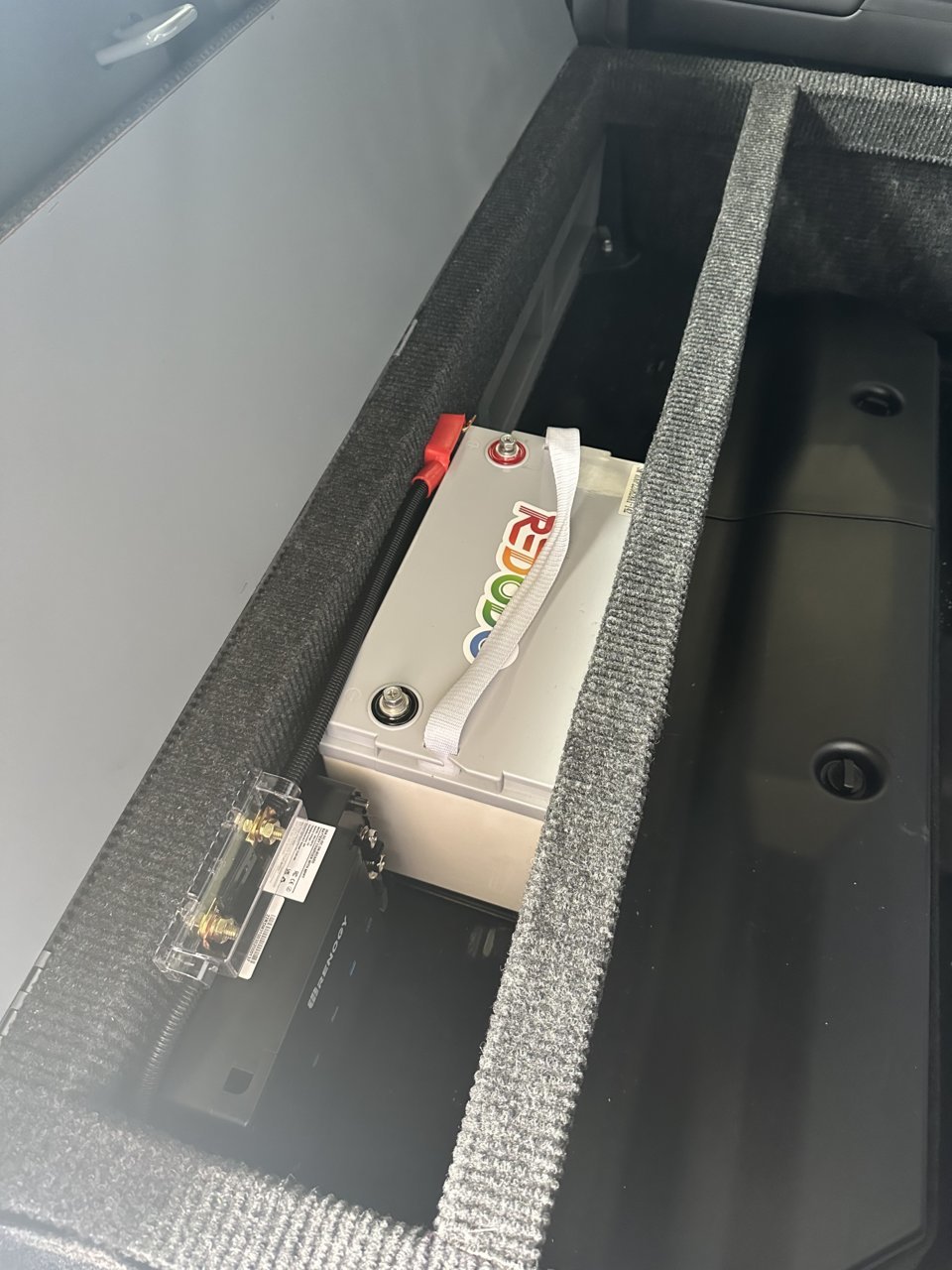

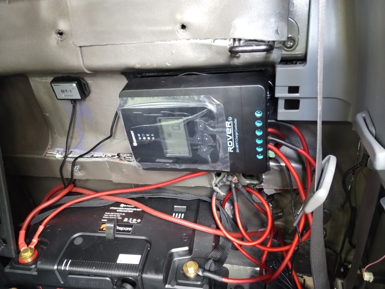

    I put mine behind the back seat. I put insulation in the entire truck. I haven't had any issues. I do not think it's a safety issue. I have a Dr. Prepare 100ah LifeP04 battery and a Renogy Rover 40a. I have 2 - 100w CIGS solar panels on the top of my camper.

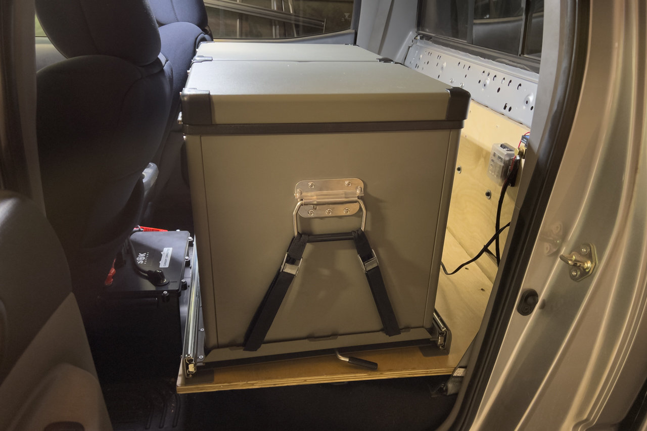

    I have the same Dr. Prepare 100ah screwed down next to my 12v Setpower freezer on a 40% seat delete board I made. Planning to tie it into a similar Renogy 20A charge controller and fuse setup but I'm terrible with electronics so I'm trying to figure this out.

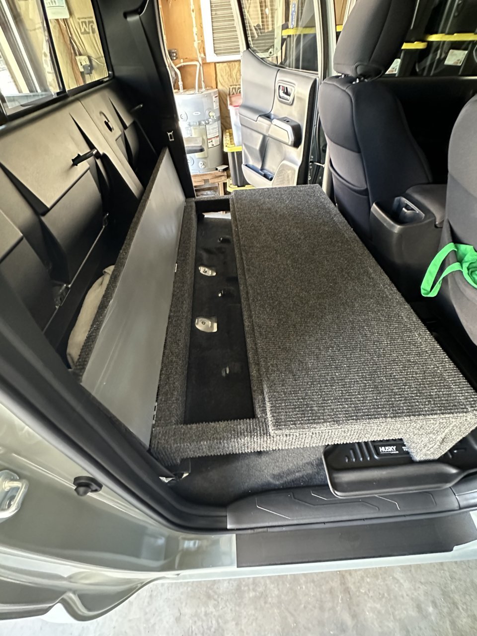

    Thanks for the replies. Guess I’m going to mount the battery and my Renogy DCC30S controller in my platform so I got to raise it another 3 inches or raise just the back half another 3 inches . Here is what I’m working with. The battery fits perfectly width wise under this door but is 2.5 inches too tall

    I raised my platform 2.5 inches and got the battery to fit, it’s sitting on a tray that’s screwed to the platform, I can’t use the usual hold down bolts so I have to figure out a way to strap it down.
