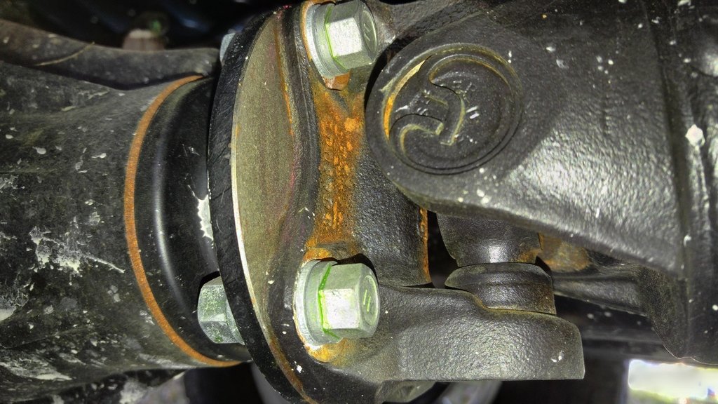

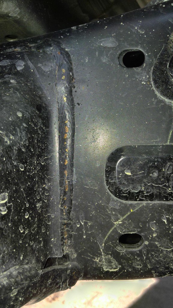

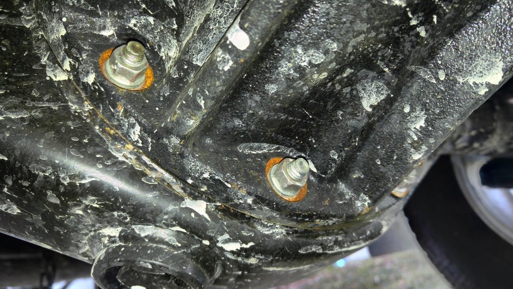

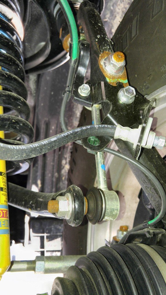

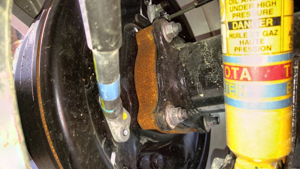

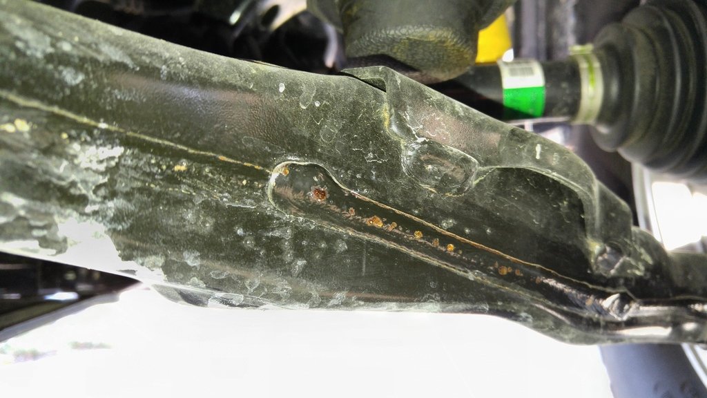

    Update: spent 4 hours last night sanding down rust spots and painting, probably only 40% complete. Going to throw the truck onto a lift at work saturday for a better angle of attack.

    OP: those first 3 pics are the only pics of the frame. they always rust first at the welds and there its scratched. looks like that's all that's going on with your actual frame. do you have any bubbling of paint on the frame itself. looks to be just surface from here
    Its obvious you live in a salty air area considering the oxidation on the aluminum and the rust on the cast iron(which always rust anyway) and from the looks of the those other parts your frame looks to be holding up pretty well. I wouldn't loose too much sleep over it op, you're' doing the right thing sanding it down and treating it. other then that those other components may take some rust-to-back paint and forget about it. those thing as will just be replaced as needed. part of the cost of living at the beach.
