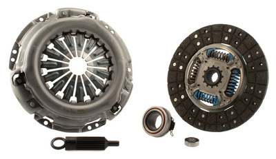

    O.k. now I'm a little lost. I just got my Aison kit and noticed that there was no pilot bearing inside. All of the pics on ebay or whatever of the kit number show one included like this pic,

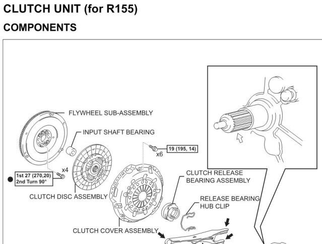

    but it never came inside the box and wasn't listed on the contents. The description on the website said 1- pilot bearing (if needed). So I'm wondering if it is necessary to change it in the first place. My repair guide shows an input shaft bearing. I looked around on the internet and can't figure out what to order or if I need to replace it in the first place. Any ideas?

    I'm assuming the pilot bearing is the throw out bearing. No u do not HAVE to replace it with a new clutch. Yes it is a good idea though because it would be kinda dumb if u just put ur new clutch in and then u have to do it all again because now ur throw out bearing is bad. But having said that, most new clutches don't come with a new TOB and they are usually about $60

    I'm all confused now. :confused: I was watching some 1st gen clutch videos and assumed there was a pilot valve on the 2nd gen to replace. I guess that input shaft bearing in my repair guide is something else. I did get the clutch release bearing aka throw out bearing with the kit though.

    The pilot bearing is the "input shaft bearing", not the TOB. I recommend replacing that every time, as that is what the tip of your transmission's input shaft rides in. I have yet to run into a 1st or 2nd gen Tacoma that does not have one.

    You haven't done a 1GR / 6spd clutch yet then, there isn't even a "nose" on the input shaft. Thats in my '06
    I can't say for the 4 banger / 5 spd crowd though, and I certainly agree, if it has a pilot bearing, replace it, every time, and replace the release bearing (AKA throw out bearing) every time.
    Edit, looking at allmotorex's photos in his link, the 2TR 4cyl / 5 spds do use a pilot bearing.

    I wasn't sure what this was in the photo:
    Anyway the pilot bearing is only $8 at the dealer so I ordered it. Autozone has a puller for $15 that I'll buy if the wire hanger tool I plan to use doesn't work. I'll get a few pics when I tear down to show the damage and obstacles.

    Wire hanger tool won't do it. That bearing is press-fit. It requires a puller (as you mentioned) to remove it. Installation can be done with a socket of the proper size, but be careful that you don't damage the race, as it is easily distorted.
