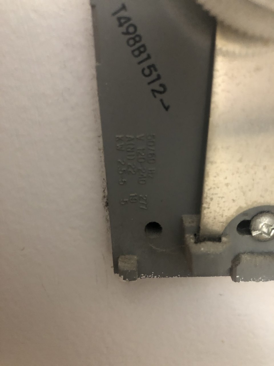

    The T498B is the model number
  3. Feb 16, 2021 at 5:03 PM
    #23
    mrcheap
    mrcheap [OP] Well-Known Member
    Apr 30, 2020
    #326364
    262
    Ok got it
    turn off breaker and replace
    I think I got this lol

    A double pole will work on a single pole heater. You just hook up one leg as opposed to two. So if you see one rated for 220v, it will work for 110v as well.

    Should be a contact switch under there, maybe clean contacts

    sorry to disappoint - but the job was completed
    1. disconnected power
    2. removed old one
    3. installed new one
    4 wires
    06Tacooo and jon_elc like this.

    I had the exact same issue with the exact thermostat. Eventually it was stuck on 24/7 and I had an absurdly high electric bill for this month. $20 replacement thermostat fixed the issue. Those line voltage tstats lose their calibration over time. There should be a set screw on that piece of metal which expands and contracts and you can adjust that set screw to change when the tstat kicks on.
