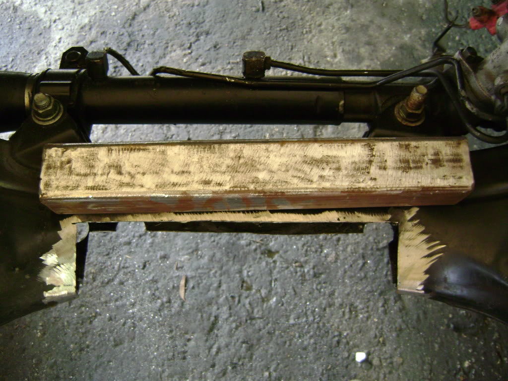

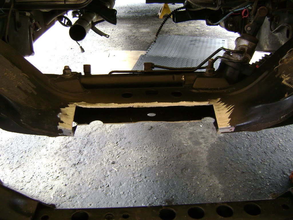

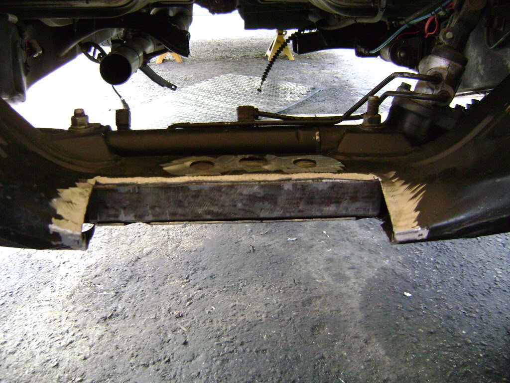

    Test fitted the motor with the GTO Oilpan, its very close, it interferes with the main crossmember so I am going to notch one or the other..
    Seems the crossmember will be easier to modify than the oilpan, I already disassembled the oilpan baffle and it will be a bitch since I need to cut and modify the oilpan and then cut and modify the baffle and reweld both.
    I would rather cut the crossmember and then box it back in with some thick material and try and reinforce it if possible, I will take pics along the way..

    Got the crossmember notched yesterday..heres the progress.
