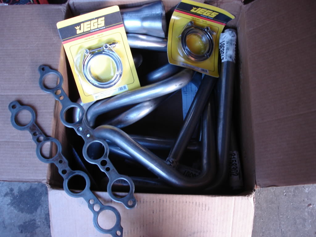

    Box of stuff from Jegs for my headers that I made..got some LS1 3/8" flanges and a header tube kit, plus (2) 3" V-band clamps, and a stock style MLS pair of header gaskets..
    Here are the finished headers, still have to install the O2 bungs and coat them..
