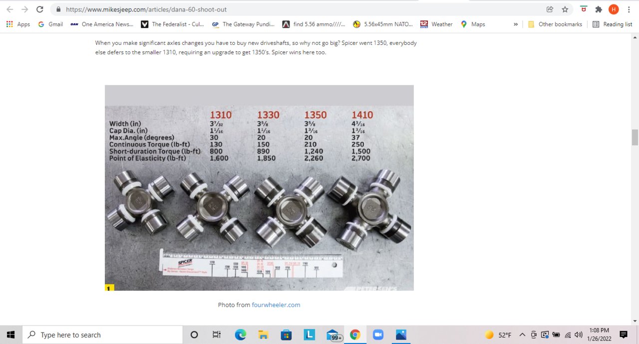

    Posting this for anyone making a future search for this info. Measured the u joint caps on my 2019 (dcsb or 4wd) at 1 3/16" so they are spicer 5-1350 for nongreasable and 5-1350-1x for greasable. If you measure the caps at 1 1/16" you have Spicer 5-1330 series 1330vs1350.2.jpg

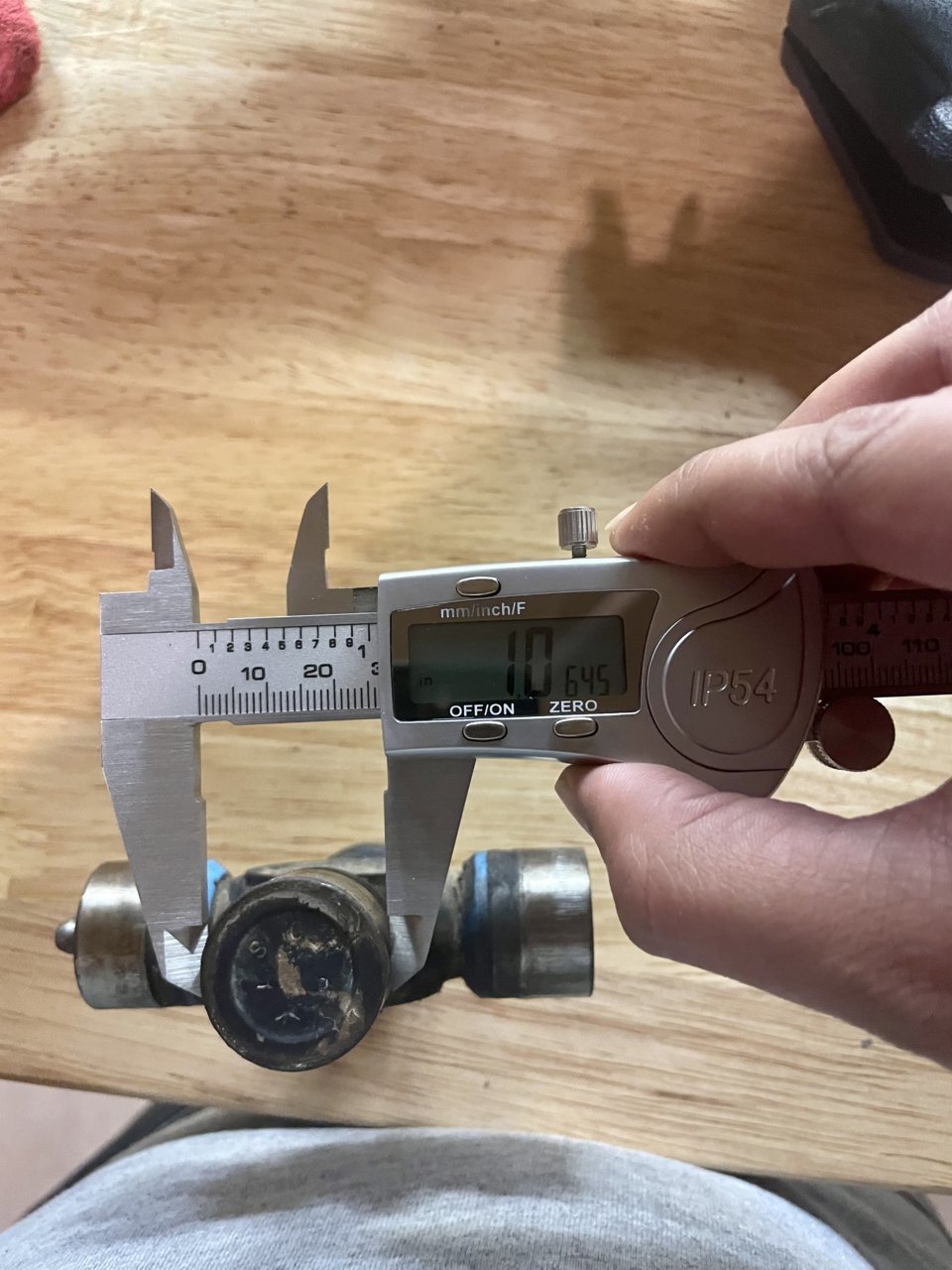

    Wanted to add to this old thread in hopes of helping others not order the wrong parts like I did. Based on Spicer's catalog, auto parts stores, and eBay, my 2016 TRD Offroad 4x4 should have 5-1350 u joints. However, after removing one, I found out they are actually the 5-1330 ones, 1 1/16". Now I'll need to return the parts I purchased and get the right size. What's weird is that parts.toyota.com shows the same part number for Tacomas from 2005 through 2022.
    Below are two pics of my measurements of the 5-1330 (used) and 5-1350 (new).

    Further research shows that 2005-2017 came with 5-1330 u joints. It seems like they started adding the larger 5-1350 u joints starting with the 2018 models. Still, the best way would be to take yours out first and measure or match them up with the correct size.
