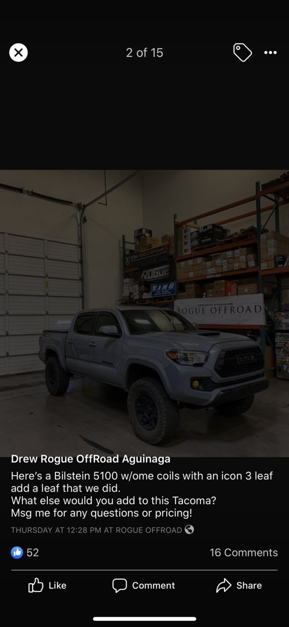

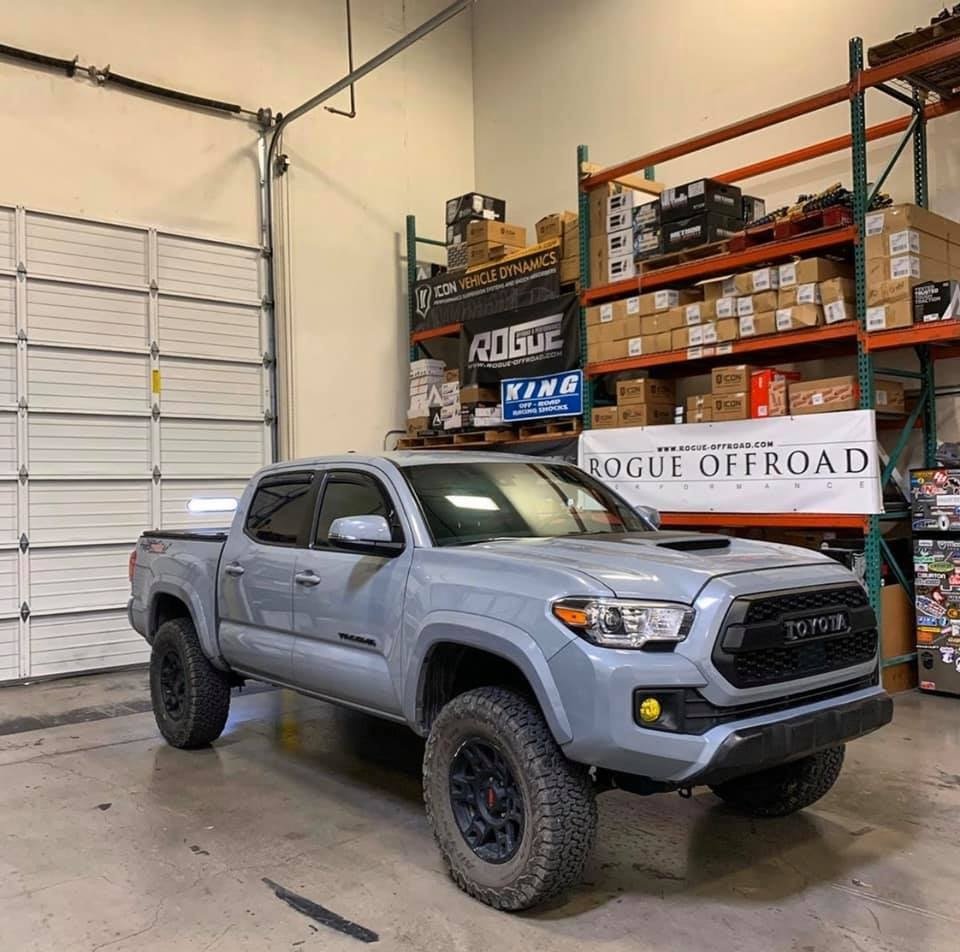

    Does anybody have any info on this truck? Mainly I’m looking for tire size and wheel offset. I messaged the guys at Rogue and he couldn’t remember what size it was. I was hoping somebody on this forum would know the truck. From what I was told it has Bilstein 5100 with OME coils up front and Icon 3 leaf AAL’s out back. I’d love to get this same look for my TRD O/R. 49E83121-296B-4548-88F5-39E3BC9A8A78.jpg

    Gonna go ahead and say 285/75 :bananadead:

    With nothing but the quoted 5100’s? You think it has spacers?

    Looks like 4runner pro wheels and I would guess 285/70r17 tires. Not sure on the offset of the wheels, but google knows

    Wheels appear to be 4Runner TRD PRO wheels. 17x7 with a +4 offset, if I remember correctly.

    Do those tires look like skinnies to anyone else?

    They don't look like 285's thats for sure.
    I would say 275's

    255/80/17

    I was thinking they looked like 255’s too. I dig it whatever it is. I’m on a mission damnit.

    K02s don’t come in 255/80.
    275 probably

    It may be the 255/75/17. I thought they didn't make it in that size, but it's the 255/80 they don't make in the KO2.

    I guess this is why they seem to have a wider stance? 4Runner Pro wheels stick out further with a +4 offset?

    I actually know the owner of that truck. He's got 285/70/17's on stock T4R Pro wheels.
    I'm running 255 skinnies on mine on the same wheels.

    Sweet! Thanks man! Got any details on his lift? And yours too for that matter.

    His is just what Rogue answered you with Bilstein 5100's with an add-a-leaf. I'm on the Eibach pro lift kit with a 1.5" Add-a-leaf.
