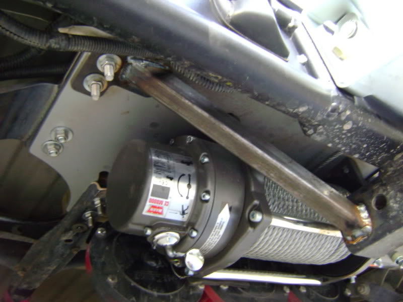

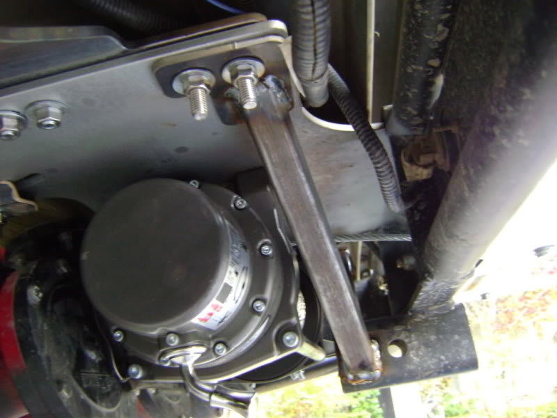

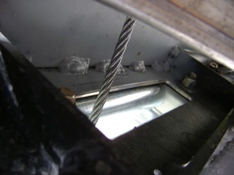

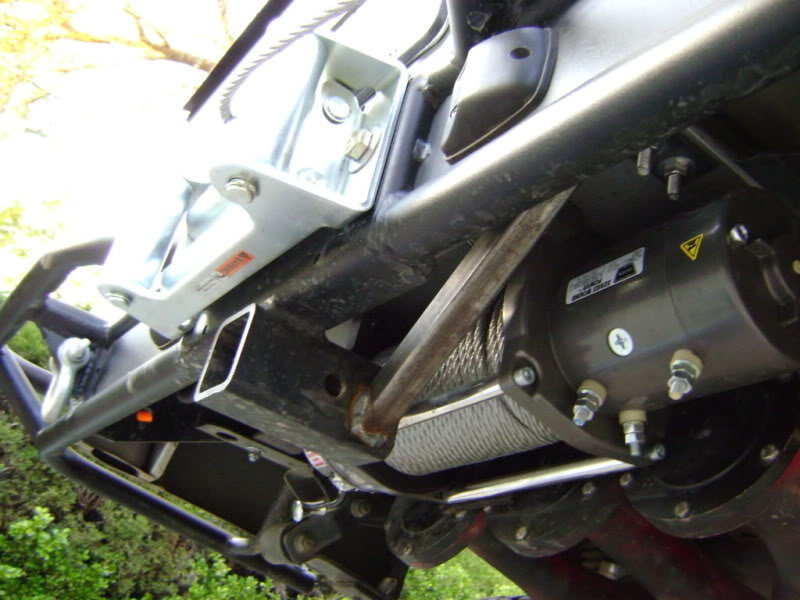

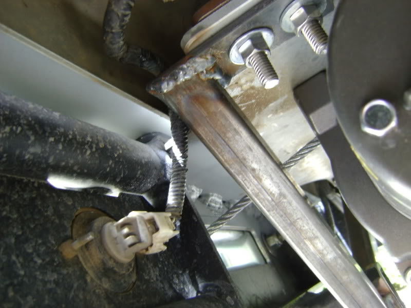

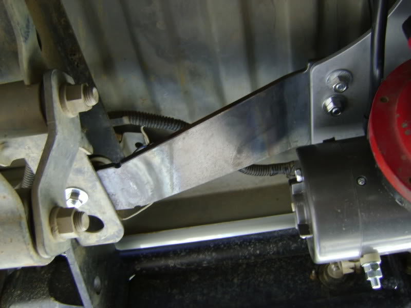

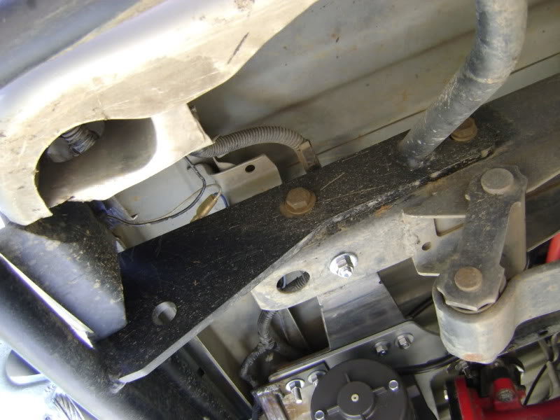

    it would be pretty easy to build a rear mount winch bumper... however i'm not sure there would still be enough room for your spare tire back there as well.
    i built this one for mine but there would be NO way to fit any size spare under the truck at all....

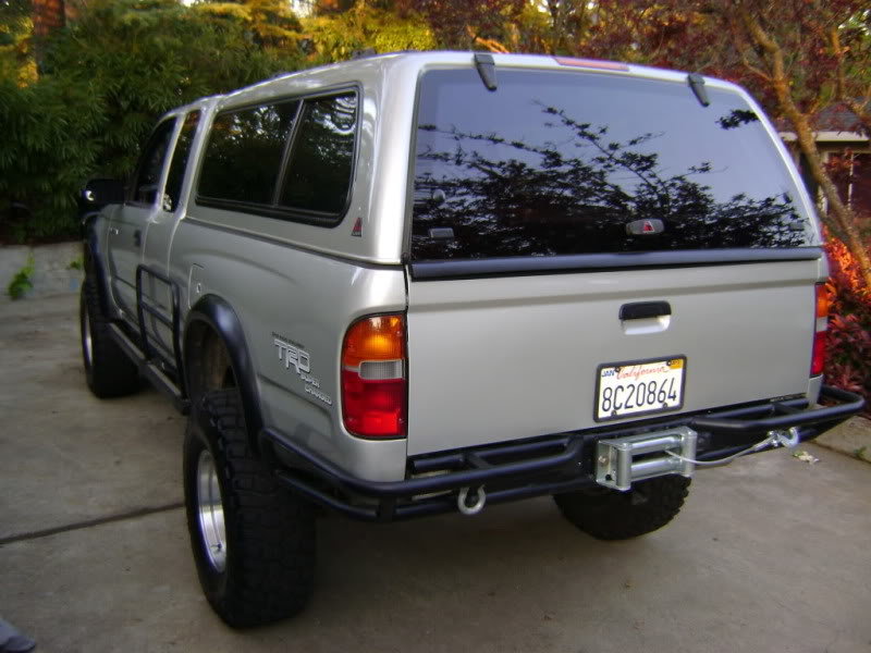

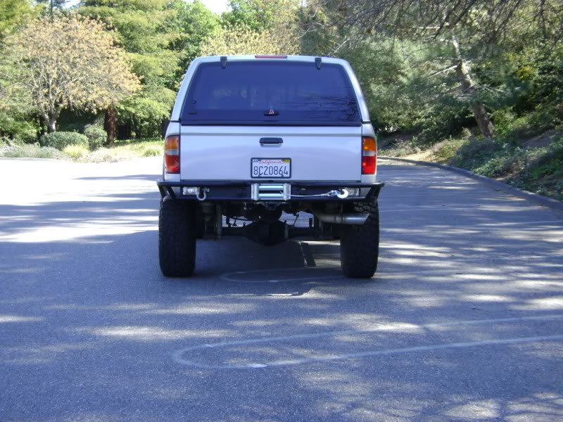

    This is what I'm talking about...

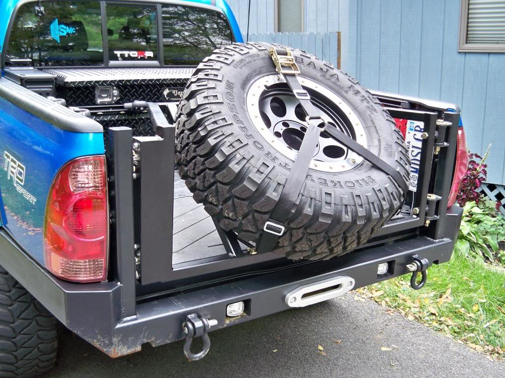

    For an All Pro Bumper:

    DUDE!!! That is Exactly what I'm looking for!!! Is that yours?!?! Where did you find that??? How Much?!?!?!

    its a standard all pro rear bumper and i'm pretty sure he had the winch mount custom built.
