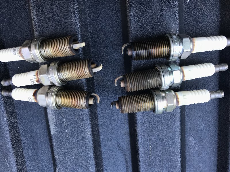

    You're crazy. My truck had the original plugs in it at 168k (when I bought it) and immediately did a bunch of maintenance items, one of which is my plugs. This is what they looked like. Upon replacement, I immediately noticed an improvement.
