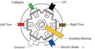

    Adapting from your 4-wire to a "proper" 7-wire is pretty involved.
    Not impossible, but personally, I'd just go with a ready-made kit.
    http://www.ebay.com/itm/320853664607?ssPageName=STRK:MEWAX:IT&_trksid=p3984.m1423.l2649
    The thing that confuses me is the auction says that it only fits trucks with the factory towing package.
    The factory towing package already includes the 7-pin connector.
    The 4-wire has left turn/stop, right turn/stop, and running lights.
    The 7-wire is actually simpler to connect to the stock truck since it doesn't combine the stop and turn... but it adds backup, electric brake, and constant 12v:
    Your 4-wire connector has an electronics package behind the taillights that combines the turn and brake into the two signals.
    I paid about $60 for my 4-wire kit.

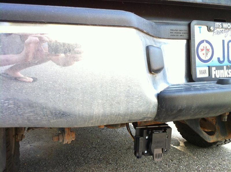

  5. May 31, 2012 at 4:40 PM
    #25
    06TAC0MA
    06TAC0MA Just another member
    Sep 9, 2009
    #22528
    17
    Jason
    Winnipeg
    06 DCLB AT SR5 2" Lift
    Icon coilovers front, OME with Dakar rear leafs. Pioneer AVIC-X8510BT LED interior lights Aftermarket Halo Fogs (in progress)
    Hey, you wouldn't happen to have pictures of that setup? I just bought a CURT 4-Way to 7-Way RV Blade & 4-Way Flat Adapter. and installed the easy part, just am going to need some guidance with the extra wiring needed.
