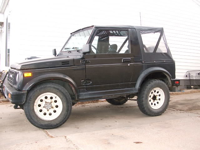

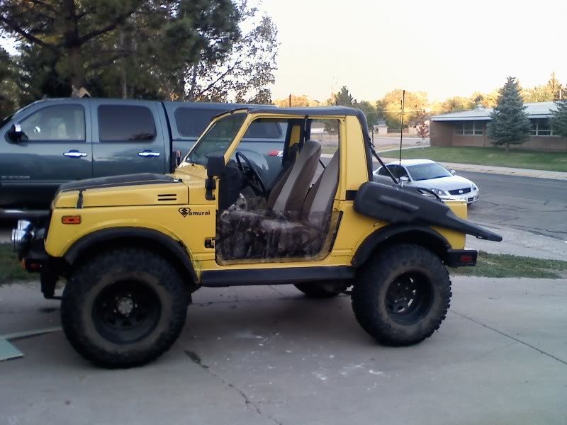

    This is a rattle can before/after. Flat paint with clear, all out of a bomb. Way more work and $ needed to make it right but temps were low and it worked well enough. All clear, if you want a really good finish, will need color sanding when it's done. That's a lot of wet sanding and then buffing. This... got neither :laugh:

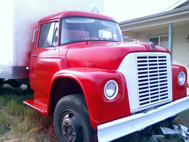

    The easier route, gallon and gun, all done with cheap paint. I hit a good 10' paint job without trying but you won't win any shows without better paint.
    No before on this one.

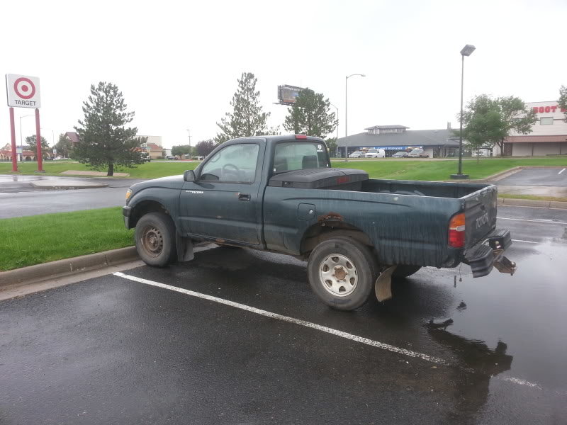

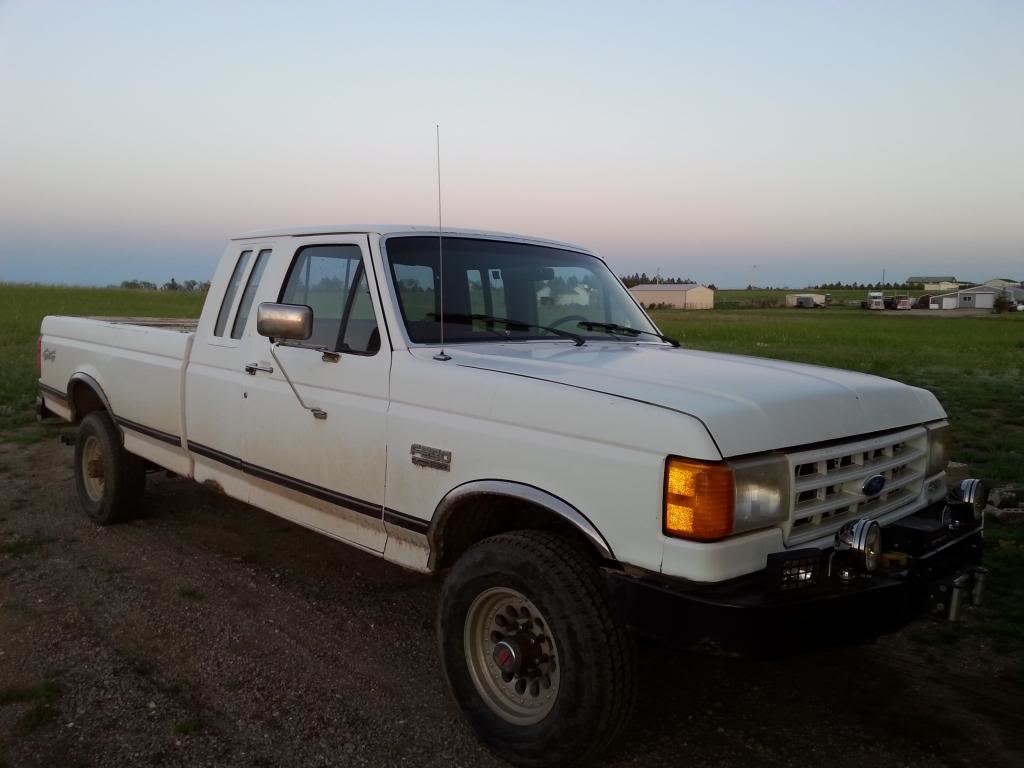

    And the one I'm working on now.
    I'll be done with the cab this week and will do the bed after. Rust fixes and a color change closer to what it came off the line with. It started as silver, someone did a bad white paint job on top of it. I'm going grey/black.

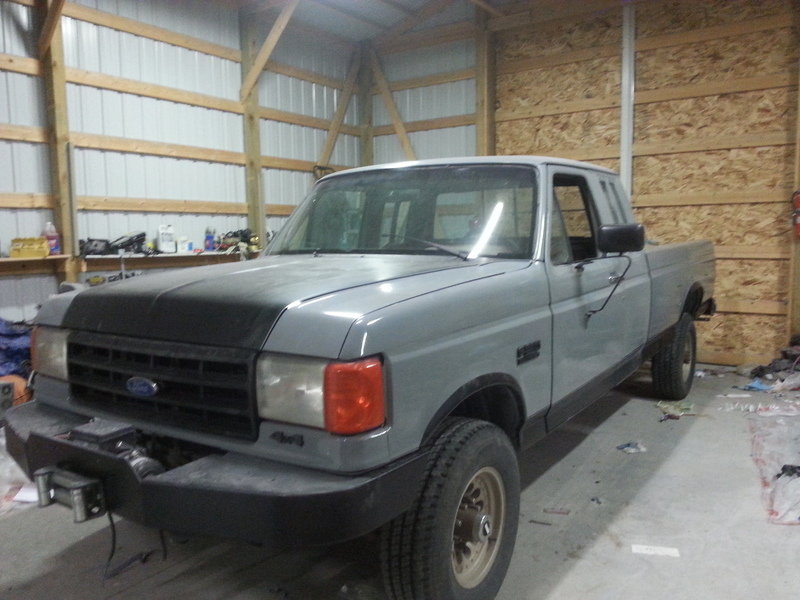

    Pretty much done with this one. I need to put the lights back on and get the 5th wheel hitch installed. It needs a bath but stayed within budget using a mix of rustoleum (grey) and dip for the black. My gun went belly up so that added an extra $30, and then I broke the drivers side headlight trying to take it off and had to spend another $40 on ebay to replace it. I've pulled engines that weren't secured as well and as big a pita as that headlight.
    Grand total in materials, $35 for body filler, $10 for metal (rust outs) $50 primer, $25 paint, $30 for plastidip, $25'ish for sandpaper. Full size, long bed, took 2 coats of color and used pretty much 1 gallon. No idea how many bombs it would have taken. The bed isn't painted, that will be getting liner after the 5th is installed, would have added another quart of material otherwise. A taco, probably 1/2 a gallon for a good 2 coats. Total gun time, maybe 3 hours with 24 hours between coats.
    Looks decent for a truck I paid 2k for 5-7 years ago. Best part, no more chrome! :laugh:

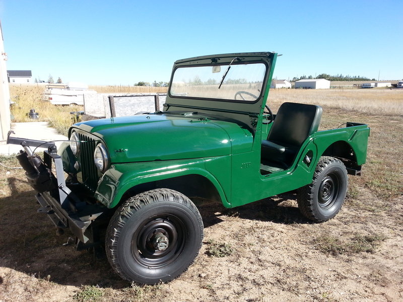

    Bored, did my willys :laugh: $25 paint job, $15 in body plastic, 1/2 a can of dip on the wheels. It's my plow vehicle, so cost is about right.
