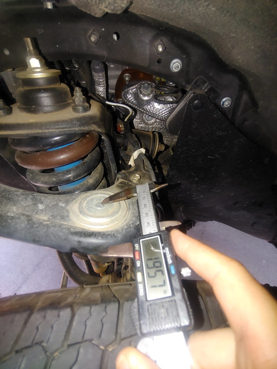

    I measured on my stock UCA, the distance from the outer-edge (part that will rub against tire) to the center of the ball joint, and it's about 2". (attached pic I took of this measurement, showing 1.957" on my calipers)
    I would be grateful if some folks could try to measure the same dimension on your aftermarket UCA, so that we could potentially compare clearance provided by various UCAs. You don't need to use calipers if you don't have one, a tape-measure estimate will do fine.
    *I know this is asking a lot, since it's not entirely necessary... so, do it only if you're curious to find out how they compare!

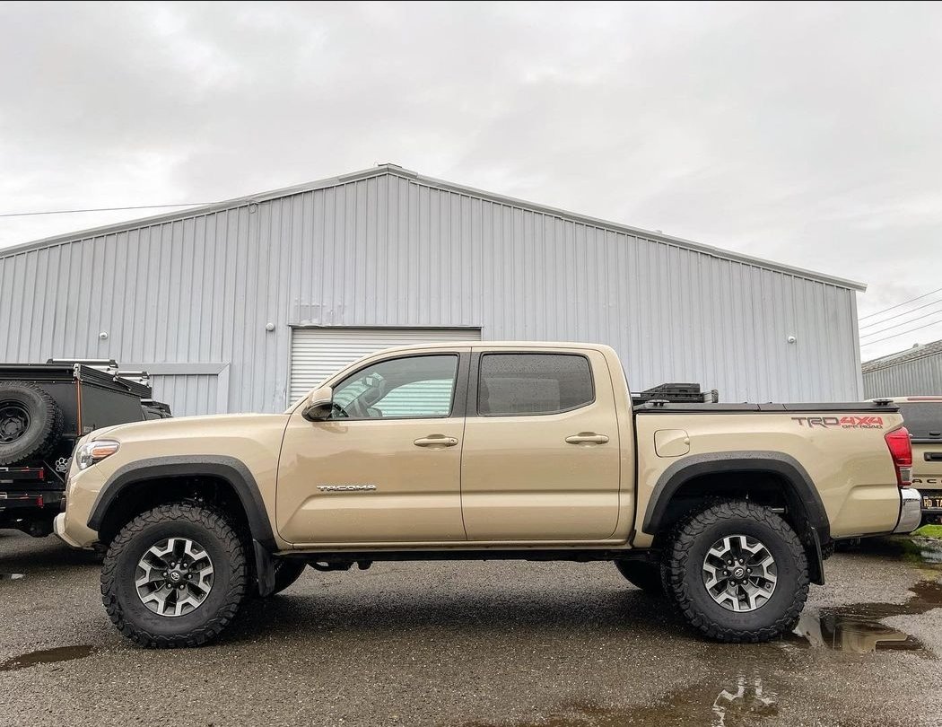

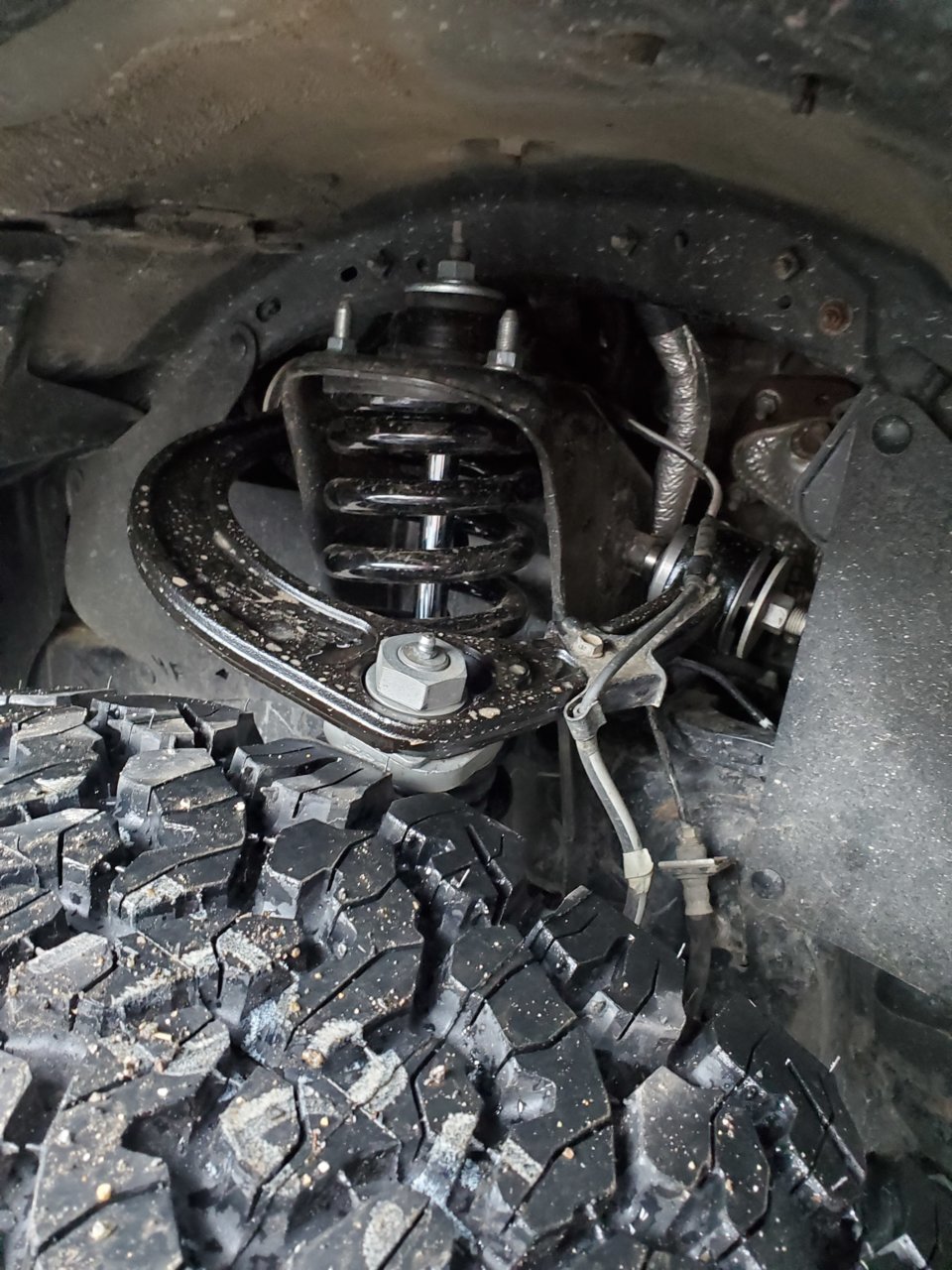

    I run KO2 285/75/16s on stock 2017 Tacoma TRD OR wheels.
    SPCs fit perfectly.
    No CMC needed and no rubbing. 20210128_153709.jpg Screenshot_20210203-085246_Instagram.jpg

    It looks like you are on the D setting (+2 caster). What is your actual caster? Did you max out the LCA to push the tire to the front (front cam fully in, rear cam fully out)? How much clearance do you have from the cab mount and front fender at full stuff? And lastly, how much clearance do you have to the UCA?

    Sorry bud, but I had a shop install them so I don't know the specs that you're asking about.
    As far as clearance from the cab mount and front fender: I've never measured the clearance (is that a thing?) but Ive been on some gnarly trails and haven't had any rub issues.
