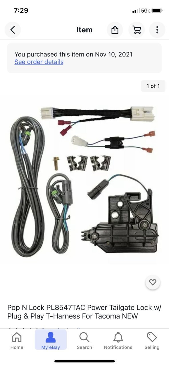

    Looking to save a few bucks on mods for the Lunar Rock that is on order. The used MGM I am currently driving has the tailgate lock. Anybody ever remove this before? I'm assuming you'd just reverse the install instructions? Also how can I tell the difference between the pop n' lock and the OEM version?

    The OEM version has a plug n play harness that plugs in behind the kick panel on the front passenger side with the door locks. I don't believe Pop n Lock plugs in like that.

    Cool I'll pull it apart and take a look. Thanks

    Son of a bitch it’s a pop n lock

    You might consider going with the OEM version on your new truck. It's plug n play with no splicing. I know you were trying to save a few bucks but it's not that expensive of a part ($128.52 at BAM Wholesale for the short bed version). You could even have the dealer install it before delivery if you want one less thing to worry about doing yourself.

    Yeah bought the OEM one about an hour after figuring out it’s a pop n lock. I’ll end up doing the install myself though. I like having projects in the garage to do

    I installed a pop n lock this week. It had a t harness that required no splicing.

    Really? Where does it plug into? I thought only the OEM version had the plug-in harness.
    EDIT: is this what you installed? https://www.amazon.com/POP-LOCK-Tailgate-2016-2021-2007-2021/dp/B00LST3022
