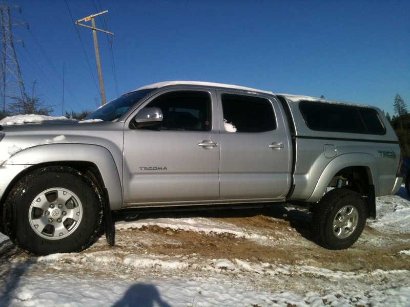

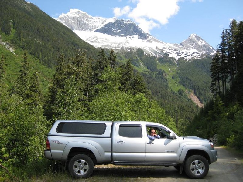

    1. My old silver DCLB 06 with a 2.5" lift sitting the 245/75r16 before putting the BFG 265's on.

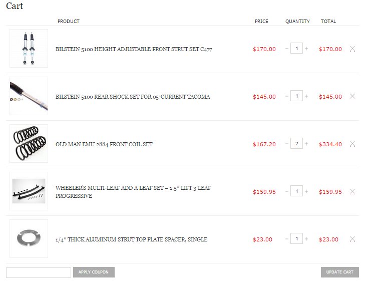

    Please take a look at my Wheeler's shopping cart. Is this everything I need to lift my new taco?
    I wasn't sure if you need Billstein shocks for this setup or Billstein Coilovers....I'm pretty new at this. Also, do I have the correct AAL selected for the rear? I'm only trying to achieve around a 2" level lift and will be running 265 tires. Your help will be greatly appreciated!

    You only need one OME spring, they come in a set for $165
    Looks good though

    Ahh, good catch. Didnt mean to do that. I'm trying to decide between the 884 and 885. If I'm not looking for a full 3" and I want a littler smoother ride, should I go with 884?
    On the rear did I make the correct selection? Take into consideration that I have a shell on the back. Again, Im just looking for a level 2 or 2.5".

    I'm considering going with the Dakar leafs on the rear which I think with my bed cap will give me a litter over 2".
    I'll go with 5100's on the front and rear but I'm trying to decide on 884's or 885's. I want the smoothest ride while maintaining an even, level lift that matches the back.
    What should I do? I'm planning on running 265 tires and I dont do much real off-roading.

    Oz, do you think I could achieve my desired 2" lift by using 885s and an Icon progressive AAL in the rear?
    If I use the dakar leafs in the rear and 885's is it possible that I get more lift than Im looking for? I dont want 3". 2.5" is the most I want.
    Also, I'm hesitant to go with Dakars because wont I need the brusings and longer U-bolts and all then?
    Thanks!!

    885's will lift the front about 2 1/2"
    Dakars will lift the rear about 2 1/2"
    So you will end up with factory rake , just 2 1/2" higher off the ground

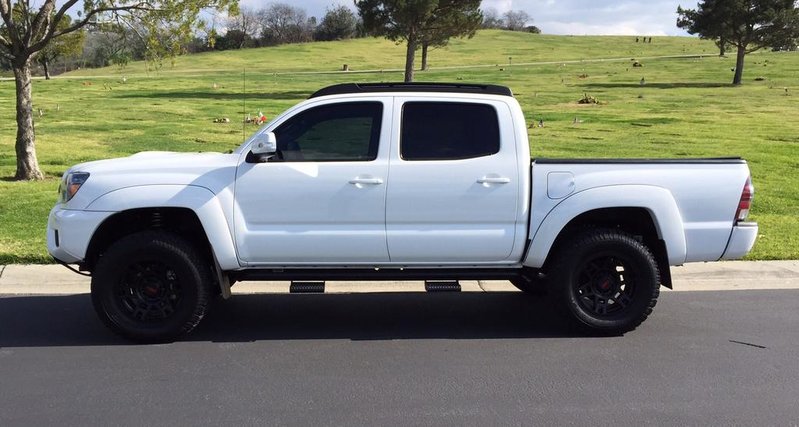

    Mine with 4Runner TRD pro wheels, BFG AT 265/70/17C sitting on Bilstein 5100 at lowest setting.
    Eibach 1.6 springs Toytec 1/2 top plate on driver Toytec 1/4 top plate on pass.
    Rears are temporary 1 inch block until I install my 1.5 AAL.
