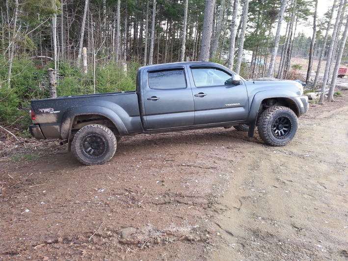

    2009 TRD sport DCLB
    3" Bilstain lift, Anytime Fog, Skid Plate, Procomp 7036, Cooper STmaxx, Heated Seats, Interior Plugs.
    2.5 front and 1.5 back, I like it alot.

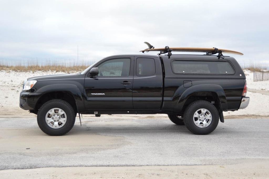

    #147862
    376
    Hayes
    Pensacola, FL
    Bilsteins on front and rear, OME 885 coils, Wheeler's AAL with overload left in, LR UCA's, Stock TRD 17" wheels, 255/75-17 BFG KM tires, VIPMOTOZ headlights, Lifetime LED headlight bulbs, 6000K LED Fog bulbs, Jumper's Interior and license plate LED's, Husky Classic floor mats, OEM bed mat, Leer100R truck shell with carpeted platform, de-badged, white derped grill emblem.

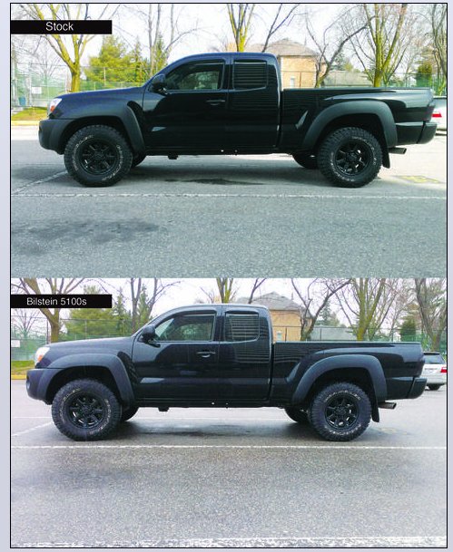

    So after all this research I've done, I thought I'd finalized my decisions on the following:
    Billstein 5100's Front and Rear with OME 884 up front + 1/4 spacer for lean
    Either Wheeler's progressive AAL OR Dakars with one leaf removed.
    Then.....I ran into this guy, "Gimmick", who says he just has Billstein5100s up front on stock coils and running 265 tires. I THINK HIS RIDE LOOKS GREAT! I'd be happy with that aesthetically!
    My question is: What's the catch? Can I get away with just what he has if I'm not doing any serious off roading?

    I only have 5100s @ 1.75 in front, stock coils. Works great for my purposes, although i'd like a top plate spacer to level it out from drivers side to passenger side.
