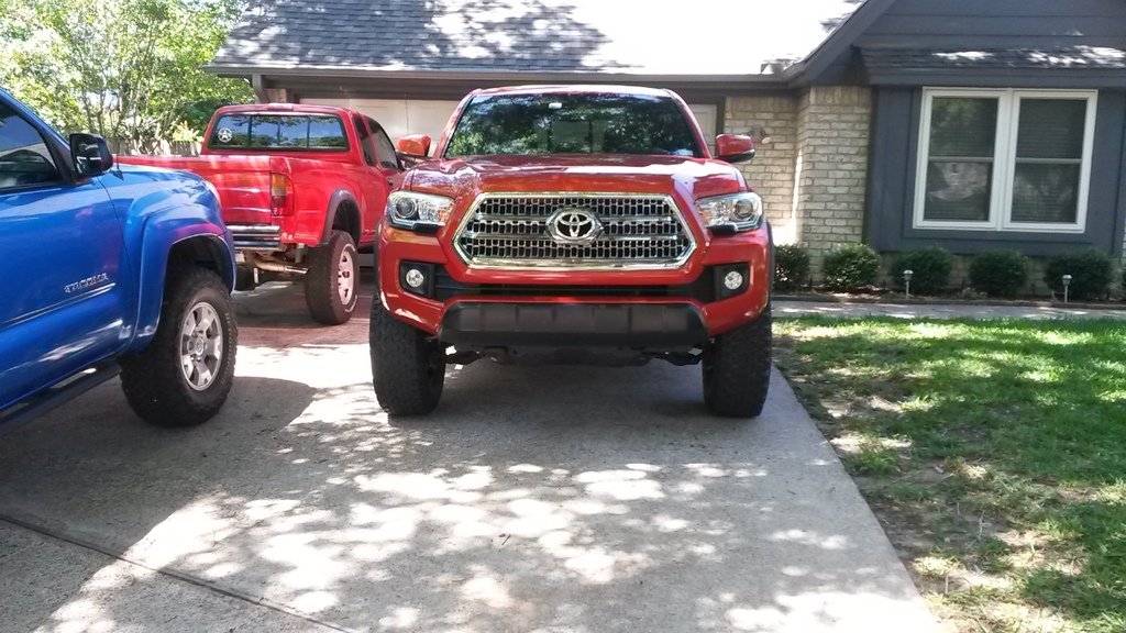

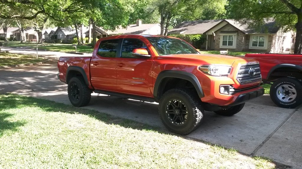

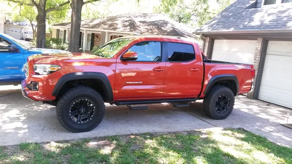

    Please forgive me that my truck is a TRD OR and not an SR5; also has a small spacer in the front providing about an inch and a half of lift. For shits and giggles I took the 275/70-17 BFG A/T KOs from my first gen and put them on my third gen.
    They look great, fill out the fenders well, and only had a little bit of rubbing. As you can see from the last picture the offset was a little too much and the rubbing might have been non-existent with a different offset, their was significantly less rubbing than when I had these same wheels and tires on my second gen. The down side was this truck is an auto trans with the 3.90 gearing and it went from ~19mpg to 15mpg (highway) and was down shifting constantly. My wife liked it so much we are probably going to regear so she can run the 275/70-17s or a 285/75-16.
