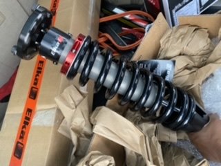

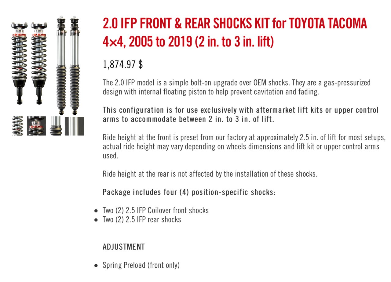

    I bought a set of SPC 25470 UCAs already, looking hard at Elka 2.0 because my application is 95% on-road, 5% forestry/hydro roads.
    If I install the pictured kit without touching the stock rear leaf packs, will my front end be 2" higher than the rear? Because that is going to look pretty weird.
    I think Elka made a typo in the parts list, they say 2.5 but it is a 2.0 kit.

    Yeah it looks like they made a typo.
    If you don't want to lift the back, then you should look at the Elka 2.0 (0"-2" lift) package.
    You should have a little bit of rake on your truck. Your back end should sit about 1" higher than the front.

    Okay, I have to confess that I am as confused as a baby in a topless bar although I have spent many hours reading threads and watching Filthy Motorsports videos.
    I do not really want to increase the step-in height of my truck because it will cause an additional expense to provide a step for my wife. I think that raising a truck that is not off-roaded is just going to increase effective drag without any functional benefit.
    I was looking at a 2" lift simply because I thought I would have more stroke which would help with speed bumps. I am not sure if this is actually correct. I also thought if I wanted to add front/rear bumpers later, I could do that very easily since I can adjust the front preload to compensate for the extra weight.
    I am starting to think I should just sell the SPC UCAs and buy the 0-2" kit. I would set it to the stock height.
