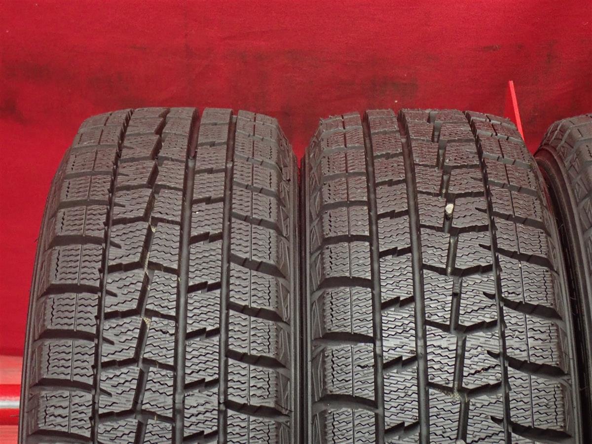

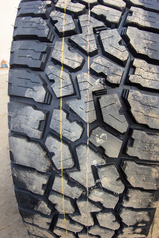

    Whatever psi you run the wildpeaks, they aint gonna be good snow/ice tires,i treid them and compared them directly with winter tires. the rubber compound is just too hard and thats why they usually get good life out of them. They also dont have enough sipes on the treads, they just dont grip on slush/ice. Just look at the difference between my wilpeaks for sping/summer/fall and my winter tires that i run in these images. 96385309.jpg s051001311_14.jpg

    Are your WP's S or LT? My understanding is that the S rated WP's have a silica compound and the LT's don't.

    Doesnt really matter both suck in winter,i have the s, ny budd has the lt on his chevy and he also doesnt like them for winter
