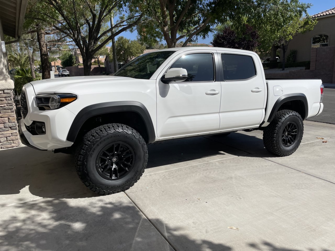

    I was just running RXT stage 2 and it gave the truck an approximate 1" rake front to rear. I know this picture isn't the best perspective, but hopefully it helps. With no weight in the rear, it was noticeably harsh.
  5. Jun 2, 2021 at 4:07 PM
    kholding1975
    kholding1975 Well-Known Member
    Feb 24, 2021
    #357311
    65
    Kenny
    Same truck, just before I switched out the wheels/tires. Maybe a slightly better view of how much higher it sat in the rear.[​IMG]
