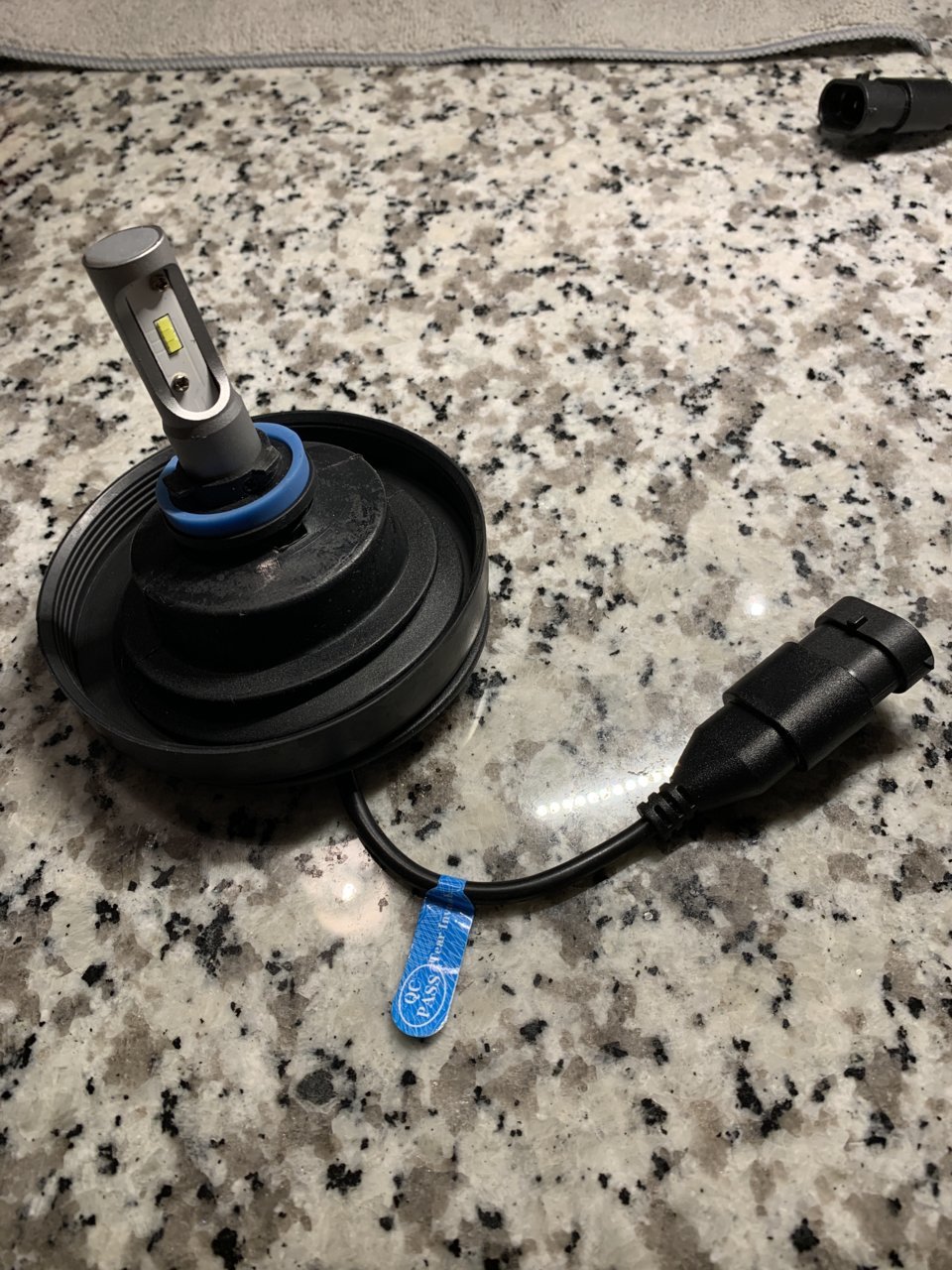

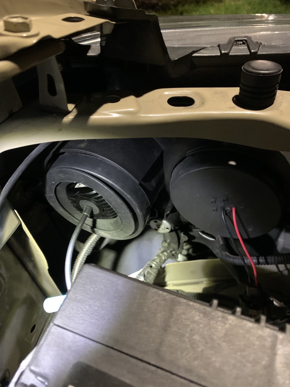

    What's up all, back with some good news.. finally got these headlights running with LED's properly. (yes I know I voided warranty...)
    Experimented with many different "dust covers" and have found the best solution. Used the factory dust covers along with some aftermarket ones to get a nice seal and has the proper depth needed for the bulb to sit in the headlight. Cutting the original dust cover and the aftermarket one was obviously needed. Currently using some H11 LED bulbs without a fan that dissipate heat out the back, I guess aviation aluminum does it's thing (let's see how long these actually last)
    They are now completely dust proof and fit like a glove around the back opening. Check out the photos below.
