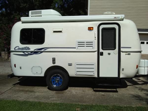

    My 2.7L pulled a Casita egg-shaped fiberglass trailer (~2300#) today with ease. The Casita owner drove my truck with my hitch and his 17ft Casita (insurance reasons). We never got over 50mph, but we drove about 4 miles on undulating black tops, common to N Georgia. The Taco did just great ! We pulled all the hills in 3rd and were able to accelerate even at mid-hill. He commented on the Taco's long wheel base making it easier. He pulls with a big Dodge 2500, and even he was liking it. :oops:
    But I didn't buy his Casita. He didn't like that ! :eek:

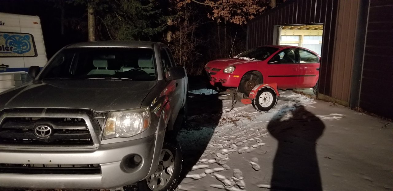

    2008 2.7L 4x4 MT and pulled my 2004 neon with a car dolly almost a 100 miles no problem.

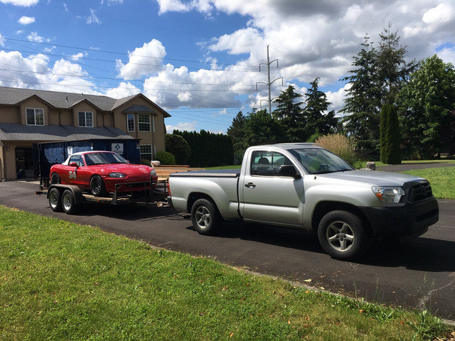

    I tow my Miata every month or so for autocrosses. 5 speed and 3.73 gears helps I'm sure since I have no problem cruising @ 70 if i need to or going up even the most challenging grades (in 3rd pushing 4500rpm, but it handles it like a champ).

    4500rpm is incredibly high for long distances. 4th gear should suffice for towing on flats.

    Oh sorry I meant that for only the steep 6-7% grades into 3500-4500ft elevation. Cruising on flat ground I’m in 5th around 2500rpm. When I had the 3.31 gears I did tow in 4th at around 2700-2800.

    4500 is fine.
