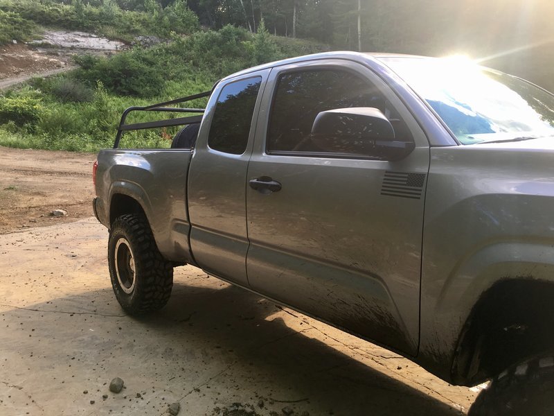

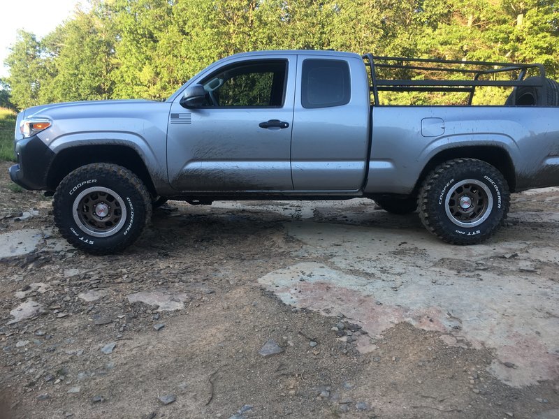

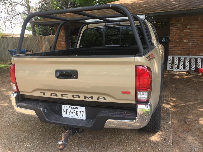

    Check in my build thread I'm my signature. I build most of my own armor and things of that nature unless it is not cost effective to do so.IMG_3303.jpg
    Also have this rack built out of UniStrut and channel iron for a lower profile when needed.

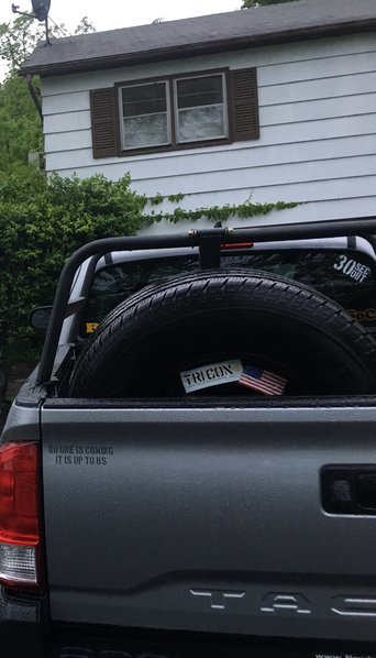

    JD2 bender, it's not that hard to bend, just make sure you anchor it good.

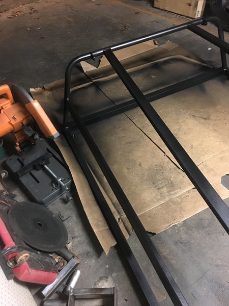

    I welded up a stupid simple pair of bed bars for holding my rtt, hilift, and traction mats. I dont own a tube bender or anything fancy, just a 140 welder and an angle grinder.
    No pictures on hand, Ill share some tomorrow.

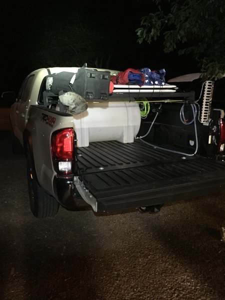

    I have an aluminum rack on my project list. But it has a few other aluminum projects ahead in the queue. I want it light and easily removable by one person in under 5 minutes and bolt on to the bed rail system. Basically I want some extra ability to carry stuff without hooking up the trailer or the ability to carry without filling the trailer up.
    I might morph it into a canvas shelled cap or make another for that.

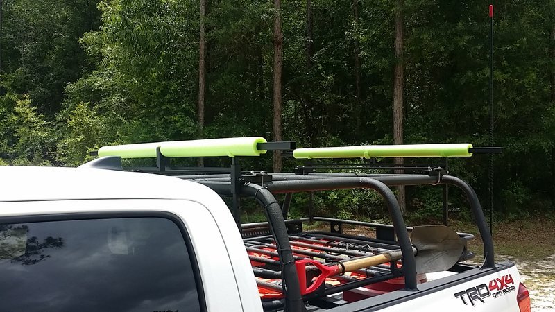

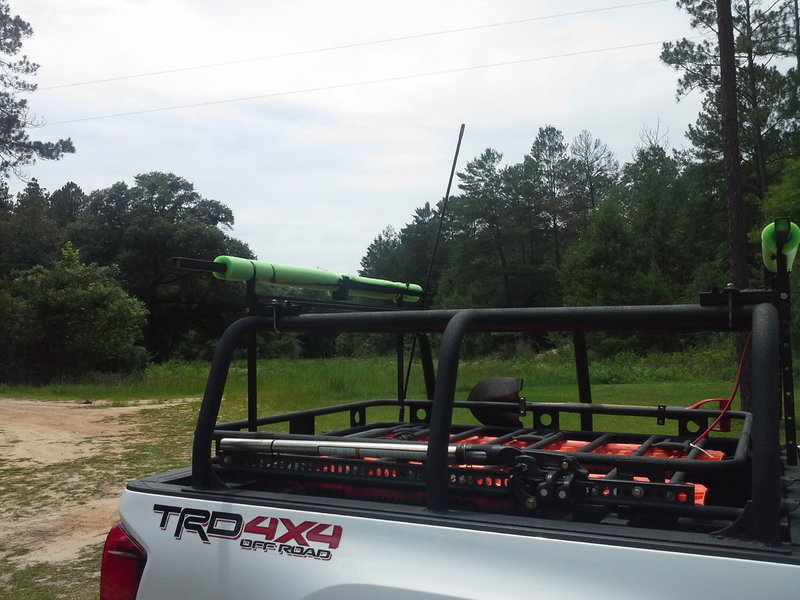

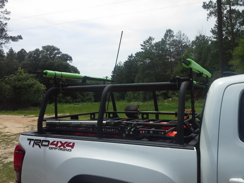

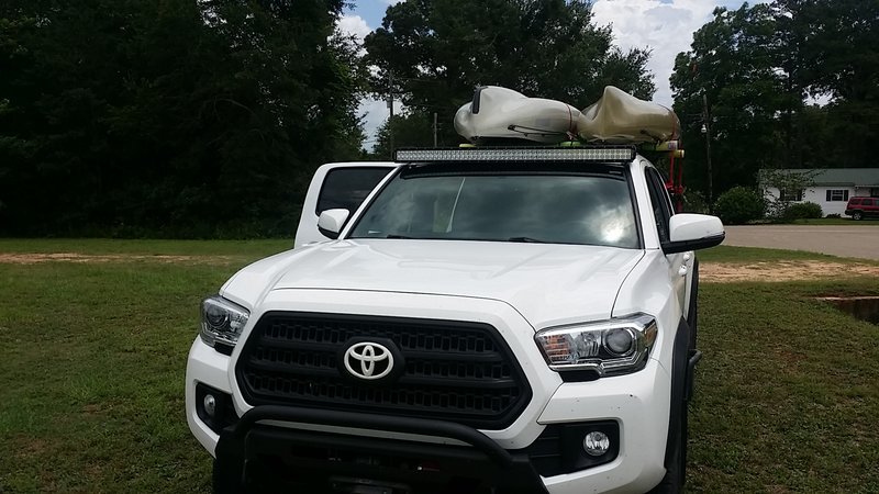

    My bed rack is Allpro offroad diy weld, I fabbed an adjustable kayak/canoe rackto attach to it. I made it adjuatable because my canvas and cedar canoe has some pretty good rocker. Made it wide enough can carry 2 kayaks . Hobie Outback and a hobie Revo 1320170616_135032.jpg
