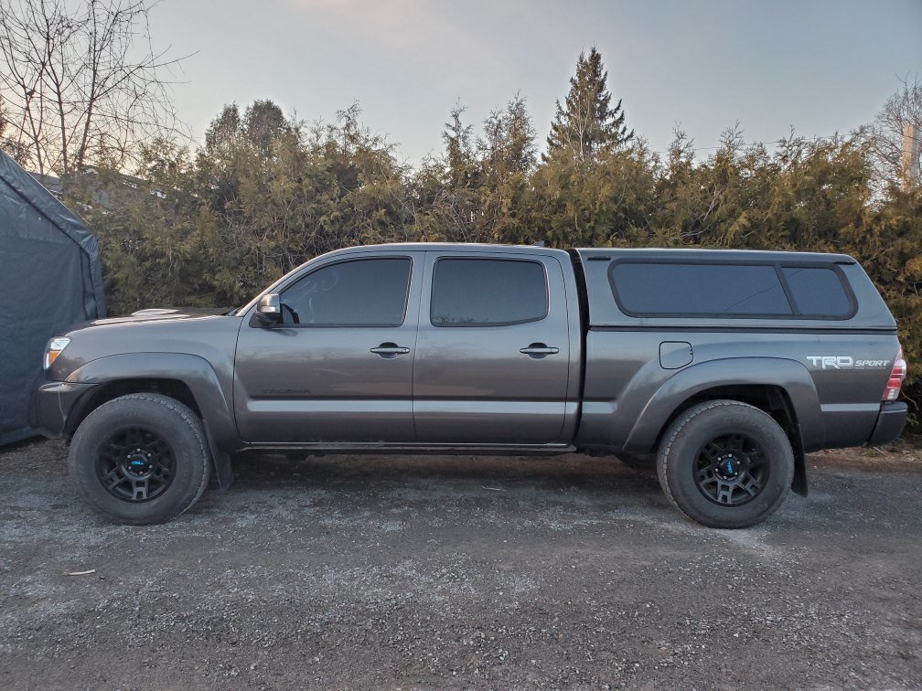

    17x7 TRD Pro Wheels Cooper AT3 4s 255/75/17 tires Frontrunner slimline II bedrack Curt hitch shackle Treeline Tamarack RTT Front air dam delete 1/3 rear seat delete
    The fit on my sport is perfect - no rubbing on the street or on the trail. Coming up on 10,000 miles, so not a long distance for data (but not necessarily easy klicks given they've already been to the artic circle and back), and in terms of wear they are holding up really well. I did have one flat while up north - picked up a screw on a utility road just off the Dempster Highway (Yukon Territory). Not sure if an E rated tire would have saved me from that or not. As for aesthetics, the ubiquitous nature of KO2's just plain old makes me tired of looking at them, so I'm happy to be sporting something different, even if they aren't all that dramatic.

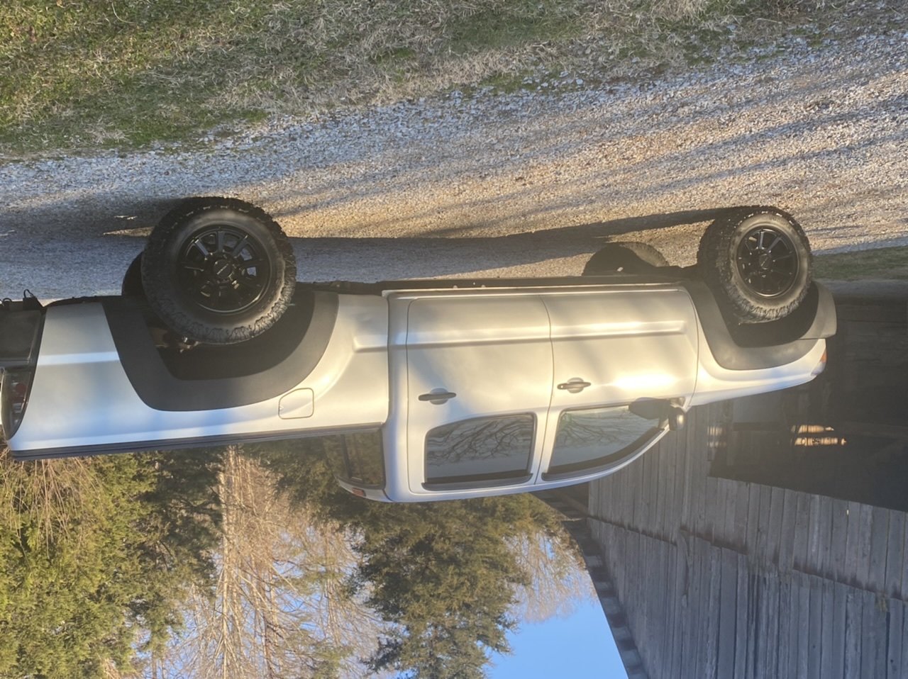

    [​IMG] I’m about to change out my Patagonia MTs for Cooper AT3 4S on my 2005. Currently I run 265/70/17 on the MTs which comes in at a diameter of 31.9. I seldom rub…only in a tight turn when in a lean. My question for you tire experts…if I go to a more narrow width (255/75/17) which comes in at 31.97 diameter…will less width in the tire compensate for possible rubbing? (Basically the Cooper 255 are 1 1/2” narrower than the 265 Patagonias) I’m leveled in the front but nothing else. I have no idea why my picture is upside down!!
