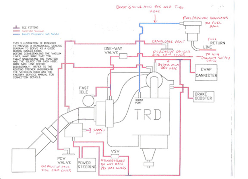

    Anytime you add more power you are putting more stress on the entire driveline. You should be OK hauling moderate loads with the SC, use common sense when pulling trailers ect. You can pull just the same with or without a SC, just don't try drag racing pulling the trailer.
    I run 93 octane all the time, to me if you are putting a SC on and plan on going the cheap route of running cheaper fuel, you'll end up paying for it down the road.
    Here is a link to vacuum routing for the SC. http://www.gadgetonline.com/Vac.jpg
    There are some lines not used based on what year model you have but this should get you by for the most part. For example, I don't have vacuum lines on the power steering or 4WD vacuum switch port, therefore I did not use those.
    If you are installing the gen 1 SC , use the factory fuel pressure regulator, don't use the one that came with the SC, the factory FPR will handle the additional fuel needed.
    There is a lot of info available here also: http://www.gadgetonline.com/Super.htm

    Toytech front coil springs Rancho tundra 9000XL Total caos upper control arms diff drop longger red steel lines rear disc conversion Pro-Comp rear add a leaf 2'' and around 2" shackle energy suspention bushings 3" body lift. Safari snorkal,Magnaflow 2.5'' catback with highflow cat,TRD supercharger with URD 7th injector kit. NGK NGK wires Oem and Denso waterpump pullys Timing belt EBC yellow front pads EBC rotors Motul fluid. Class C Tow hitch and drop hitch sliding rear window 6x9 kickers with pioneer deck 1000watt amp 10" sub B&M shift knob URD short shifterGT Grant steering wheel occ floor Mat cammo seat cover.
    I just installed my supercharger this weekend and I need the throttle body gasket and maybe some vacuum lines routed the correct way. I got it used and its the 2nd gen on my 97 4x4 5 speed black tacoma v6 3.4.
    I really wanna get it running better and get a wideband and boost gauge.
    I drove it home from my shop and it was fine just doesnt have more power yet. Cuts out after over 1/2 throttle.
