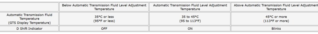

    Possibly check your fluid level? Toyota’s, all of them, have a history of low fluid from the factory, it was almost expected for a while on the 3rd gen.
    Both my 3rd gens had low original fluid from the factory. After I topped them off, both smoothed out nicely.
    Don’t bother with the dealer, they’re going to tell you to buzz off because, their favorite slogan, “it’s normal”, and to do it right it has to cool down, be filled, then warmed up to its check range. They can’t be bothered with that.

    It's a sealed trans, just like the 3g. Crawling underneath to check the level can be messy. I'd take my new truck with a warranty to the dealer. If the service invoice comes back with "topped off with fluid" you now have evidence that Toyota screwed it up from the beginning and compromised your transmission (if it fails after warranty).

    it’s no worse than an oil change. Get it in temp check mode, and pull the stand pipe drain. If it’s completely dry, you’re underfilled, both mine were. I added almost 1/2 qt to both of them.
    I ran out of dealers in the area willing to do this simple check on both my 3gs. “It’s normal for these trucks”…”it’s what they do”. Everyone wonders why dealers get the reviews they do.

    yup its even easier on the 4th gen because you don't need any jumpers to get into AT temp mode. For anyone curious, to get into AT temp check mode on the 4th gens, you move the shift lever between Neutral and Drive within 1.5 seconds for 12 seconds. Wait until the D illuminates for 2 seconds and then turns off. Put the transmission in Park and wait until D illuminates on the dash. Then you're in the specified window and can check the level using the overflow plug.
