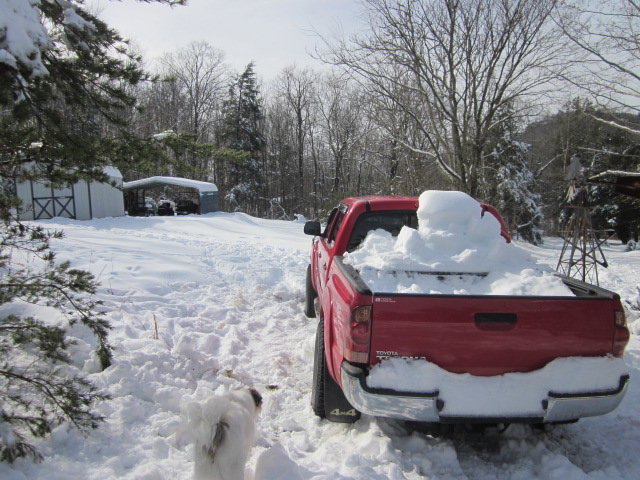

    When you are shoveling snow off the driveway or walk ...... fill up the bed of your truck with snow.

    • +1 This was my MO for the best part of 15 winters. I have to shovel anyway, throw a dozen shovel fulls into the bed, gives you weight for traction. Won't turn into a projectile (see below). Don't need to lug it around until you actually need it, And most of the time it melts ~ the same pace as the snow on the ground so you don't really have to unload it.
    • Once during a long cold spell I had one of those tubes of sand tied to the back corner of my never garaged Gen-1. Worked fine but had evidentially turned into a frozen solid 50lb projectile. A month or so in, the rope breaks and scares the heck out of me sliding up the bed liner into the cab...

    Yup, that works...

    I'll take your word on that. I even once thought of doing it, for maybe 2 seconds until I realized my garage would turn into the next Great Lake overnight.

    Works for me since I don't have a garage, and have to park outside...

    I'd do the same if mine wasn't garaged especially since snow is free and I'm a cheap bastard.
