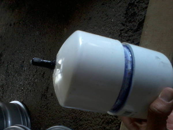

    They're easy to make. I built this one a couple years ago but haven't used it yet. [​IMG]
    I just went to Home Depot for the pvc pieces and glue and a automotive store for the valve stem. I wouldn't recommend putting the sensors in the spare in case you ever need to mount it....some use a wheel barrel tire. They do make large hose clamp type straps though for mounting the sensors to the inside of wheels.... http://www.revolutionsupply.com/strapkit.aspx
