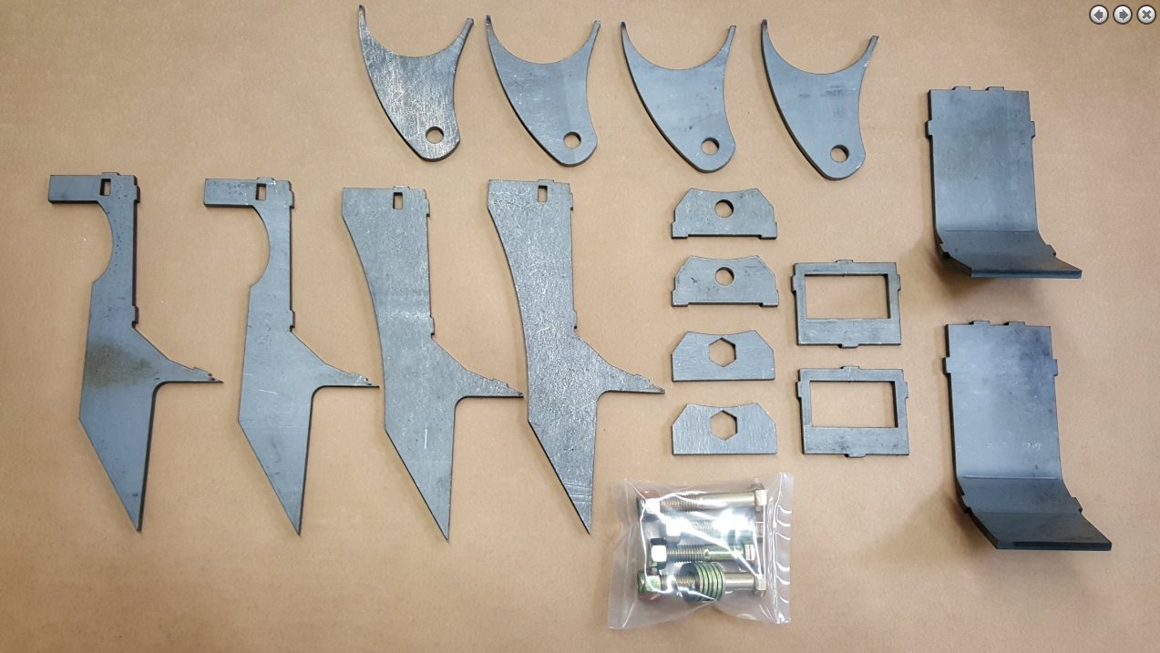

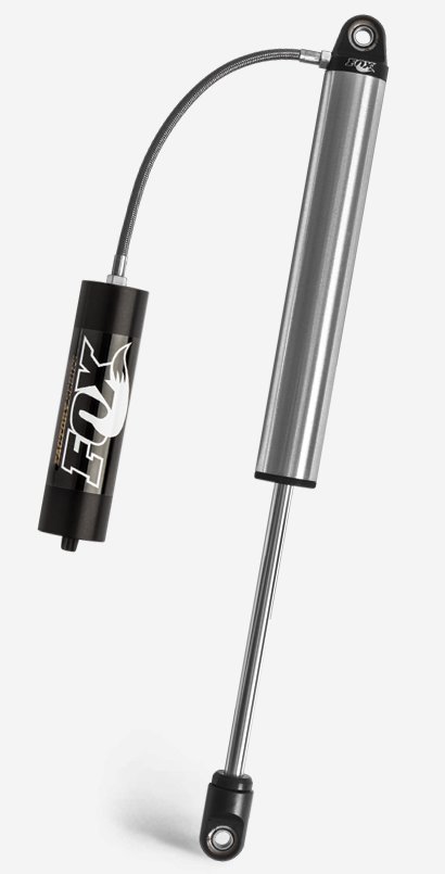

    The rear shocks, from what I can see are 12" stroke with a stem top and eye bottom. I assume you intend to run these to the factory mounting points? These will be too long for that. If you want to run a 12" rear shock you'll want to add the BAMF shock relocation kit and go with an eye to eye 12" 2.0 rear shock. otherwise I'd recommend something in the 9-10" stroke length for the stock mounting locations.

    @eccracer104
    Good input, thanks for that.
    I believe that I had listed BAMF's SRK, but I could be wrong. Adding to what you mentioned about said kit, it would be safe to assume that parts required for E2E shocks are included, correct? I don't recall seeing that mentioned in the product description.

    Yep it's in there. I somehow missed it when looking through. :facepalm:
    Looks like it comes with the nuts and bolts required for the upper and lower shock mounts -
    You'll need a 12" shock like this -
    https://www.ridefox.com/filter.php?m=offroad&t=shocks&f1=type&v1=Smooth Body
    They might have a non resi version, I just didn't see it on their website.

    @eccracer104
    Good eye on the BAMF kit, I totally flubbed that. Looks like ive got motivation to make a trip up to VA to get my welder.
    Oh yeah, almost forgot, Fox’s eyelet version 985-24-006

    Yep, that part number looks good for a 12" smooth body, non resi, eye to eye mount.
