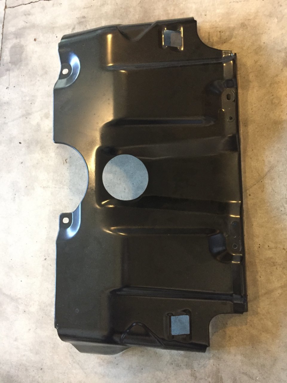

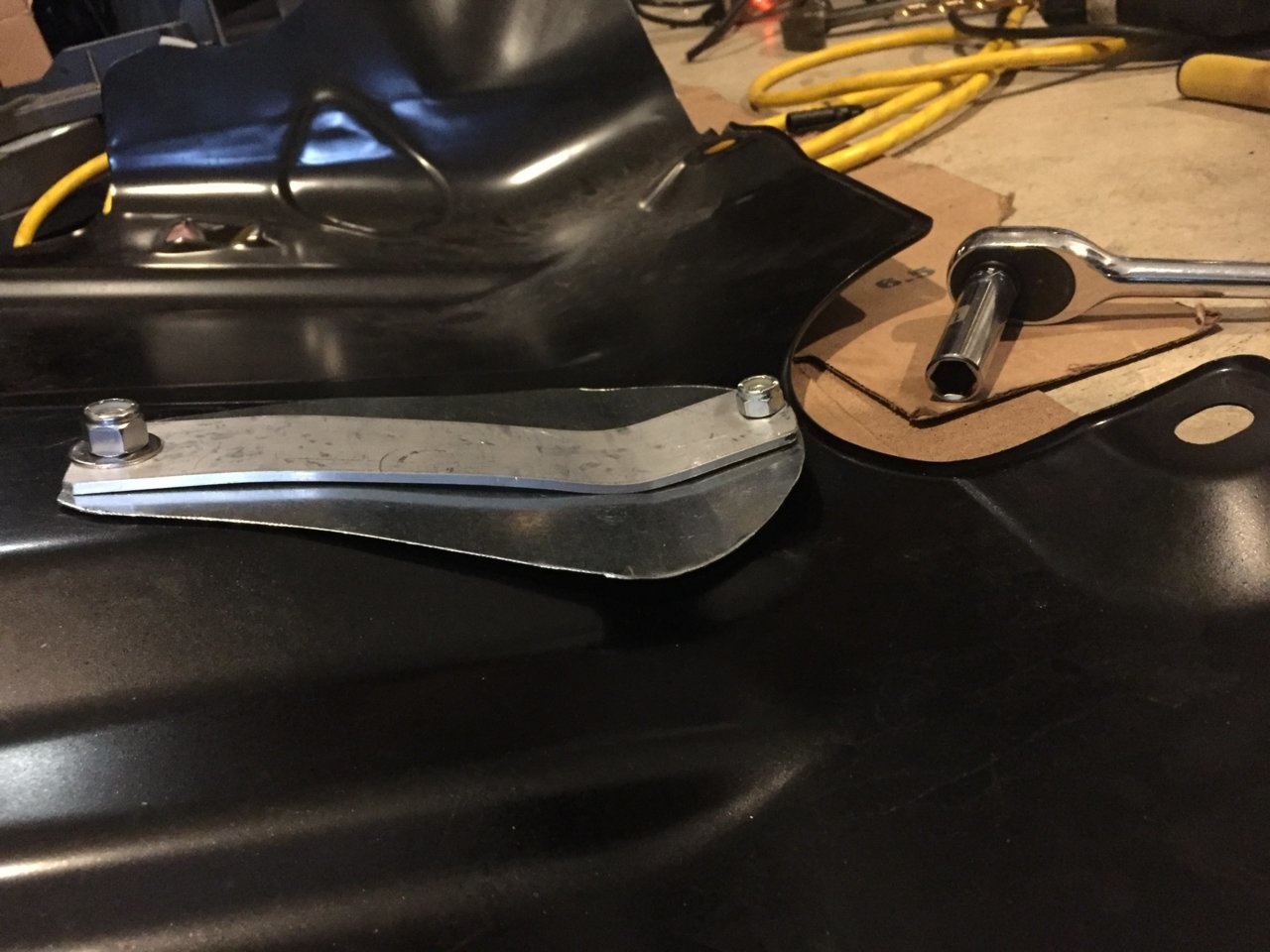

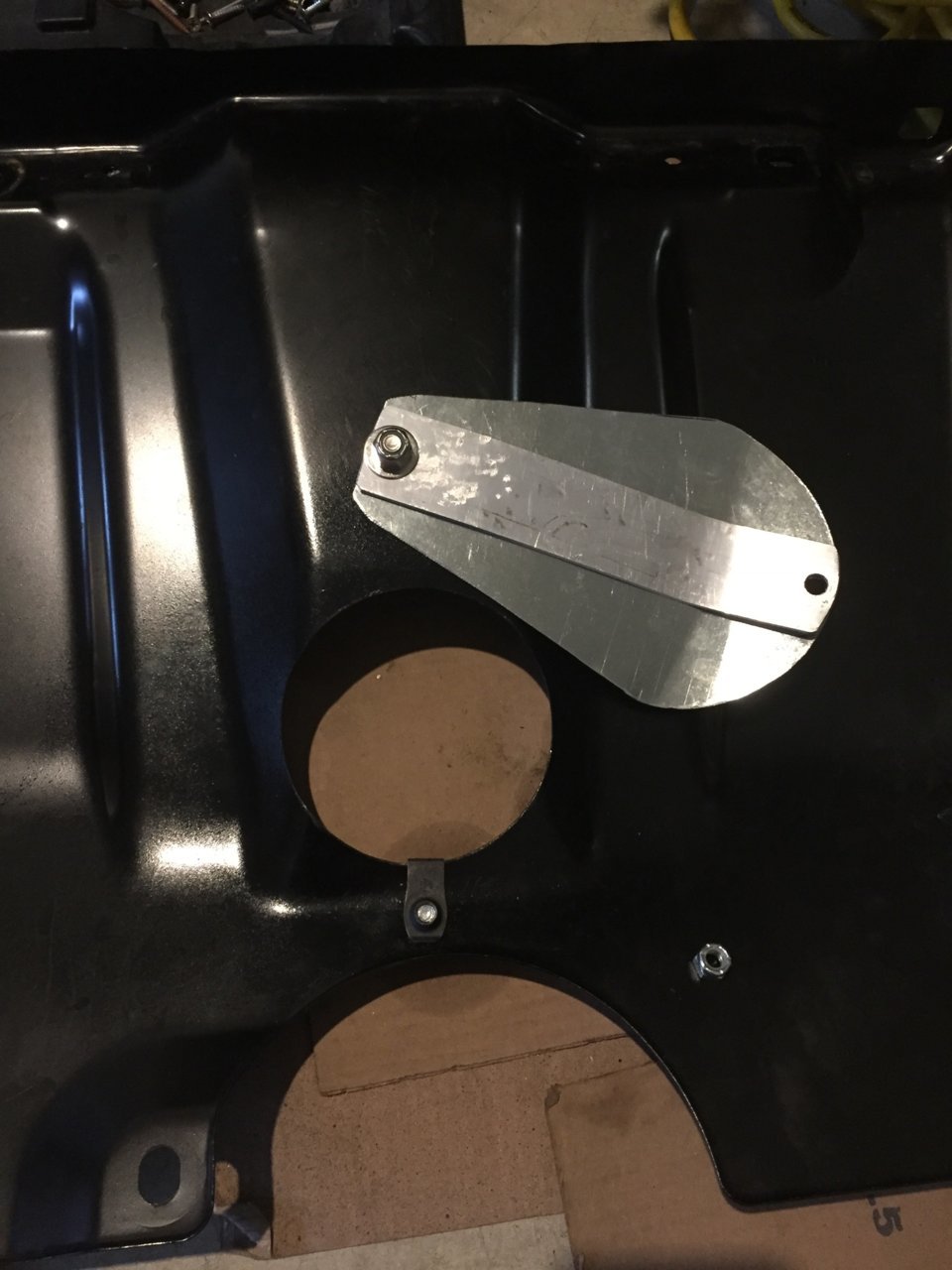

    I think that a proper skid plate with access hatch is the way to go. Small screws are easy to remove and the small hatch is easier to handle than a large skid plate.
    I still haven’t purchased a set of aftermarket skid plates for my Tacoma. I have yet to sell the full set from the new F-150 I traded in for the Tacoma.
    This was done to the stock deflector shield over a year ago, just for the heck of it.
    It was easy to use a hole saw on the thin metal.
    Super easy access and the second bolt isn’t even used. Just rotate it out of the way.
    It’s stays in place and doesn’t rattle.
    Used scrap pieces in the garage.

    I like this and was thinking of doing something similar. Have you done an oil change yet, and what size is the hole?

    4.25 inch hole saw. I used it for a second time oil change a few weeks ago and it works well.
    Placing a large rag or shop towel on top of your skid plate or shield helps to keep it from getting messy in case of any spillage.

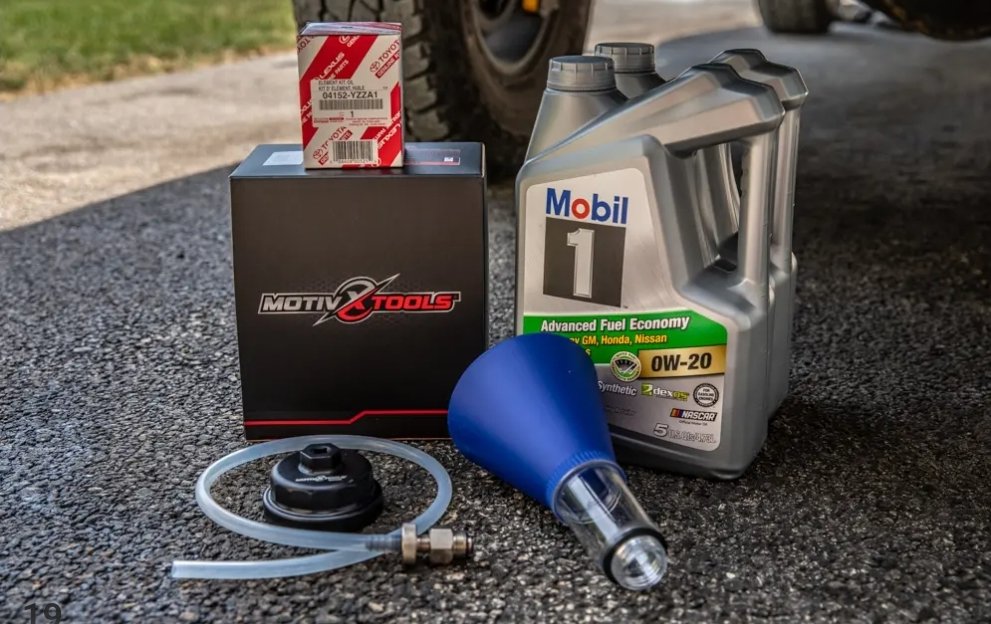

    I took this photo with the Access Plate removed.
    I will be doing an oil change this weekend and give some feedback on the ease/difficulty of removing the oil filter housing.
    The MotivX drain tool should help pre-drain before removing the filter housing.
    I got the funnel too! (FIT TEST)
    The drain pan shouldn't be too messy but...that's part of doing an oil change.
