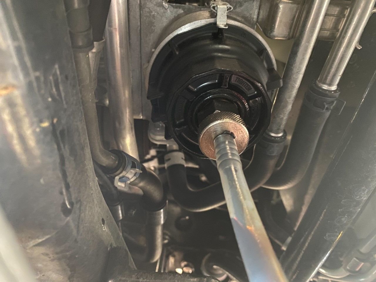

    Yes, it was messy for me and I was a bit frustrated with the spillage. Using some clean up wipes specifically designed to absorb oil takes care of the mess.
    This drain valve works as advertised!
    I had to use one of two options to remove the oil filter housing...and it involved using a breaker bar and a larger socket.
    It can only get better...getting familiar with how I approach each step.
