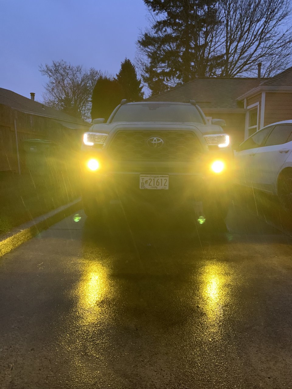

    I purchased the diode Dynamics SLF1 Yellow fog lights. I had nokyas but one burned out yesterday and only had them for 4 months.

    Drop in LEDs like these cause excessive glare to oncoming traffic and are not legal. The correct way is to use a yellow halogen bulb, like Hella or Nokya, for the halogen assembly or swap to an SAE LED assembly like Diode Dynamics SS3 in selective yellow.

    2003 DCSB TRD OR
    They do perform horribly, the glare is excessive. You must not be aware of what to look for if making a statement like that. You cannot move an LED emitter off center and change all the lighting geometry for the lamp and not produce excessive glare. The multi-color changing LEDs use multiple emitters to achieve the color change, which means that no emitters are correctly positioned on center. It is not possible for that design to work correctly, which is why no reputable manufactures sell them.
