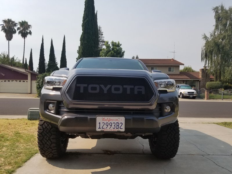

    20160731_095812.jpg Color matched and its easy to clean and get this its metal:rofl::rofl:

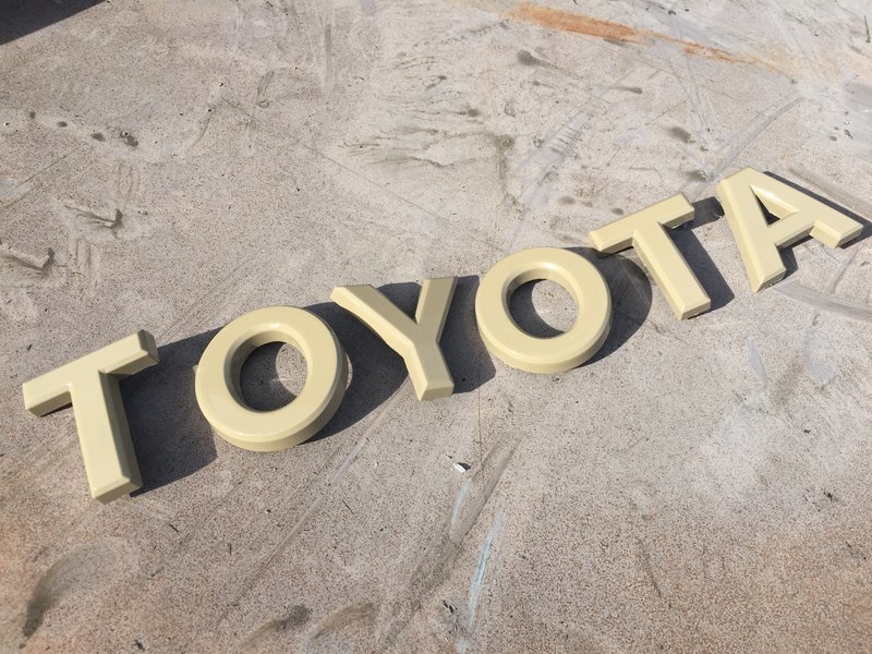

    Hey guys I know some of you have tagged me in this post asking about how I painted my letters in my TRD pro grille... So I just popped the letters off and painted them.. Be careful not to get the double sided tape that's on the grille dirty. Because you can reuse that tape that's on there and just stick the letters back on... You DONT want to heat up the letters before you take them off... My friend tried that and the enhesive became"gummy" and some of the sticky part pulled off with the letters and it made it less sticky when my friend tried to put the letters back on.. So just use alittle bit of force.. They will come off :thumbsup:
  11. Nov 10, 2016 at 9:46 PM
    iHoopAlot
    iHoopAlot Well-Known Member
    Jun 20, 2016
    #190079
    942
    Joey
    2017 QS Tan DCSB 4x4 Offroad

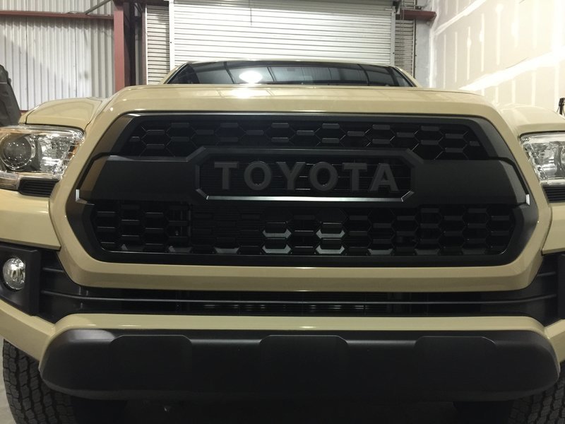

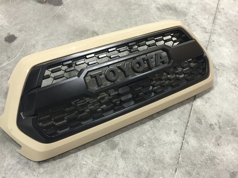

    Here's a couple pics of my grille with the blacked out letters... For those who haven't seen it yet.. I actually popped them off again and had them color match Quicksand Tan to match the truck... I'm picking the letters up tomorrow from the paint shop... I'll post some pics after I put them on the grille

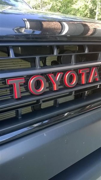

    I painted mine. I removed the letters, painted them red, and then added matte black decals over that. It turned out really nice and the decals have lasted for at least 3 months now.

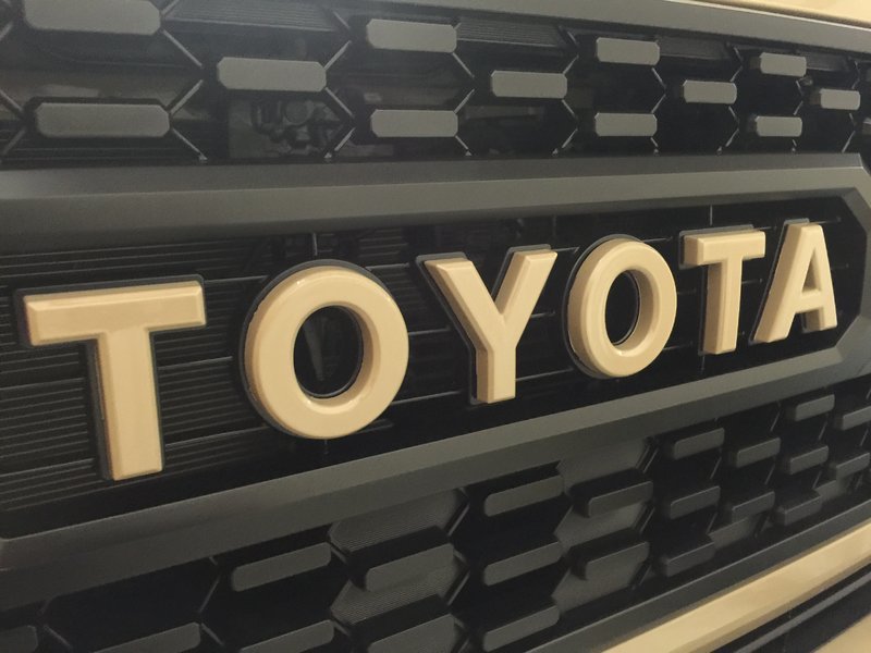

    I recently painted my the TOYOTA letters on my TRD pro grille black... But I decided to take them off again and repaint them QS tan to match the truck.. I liked the letters black but I kind of wanted the letters to stand out alittle more.. So Here's how it turned out..
    BEFORE&AFTER
