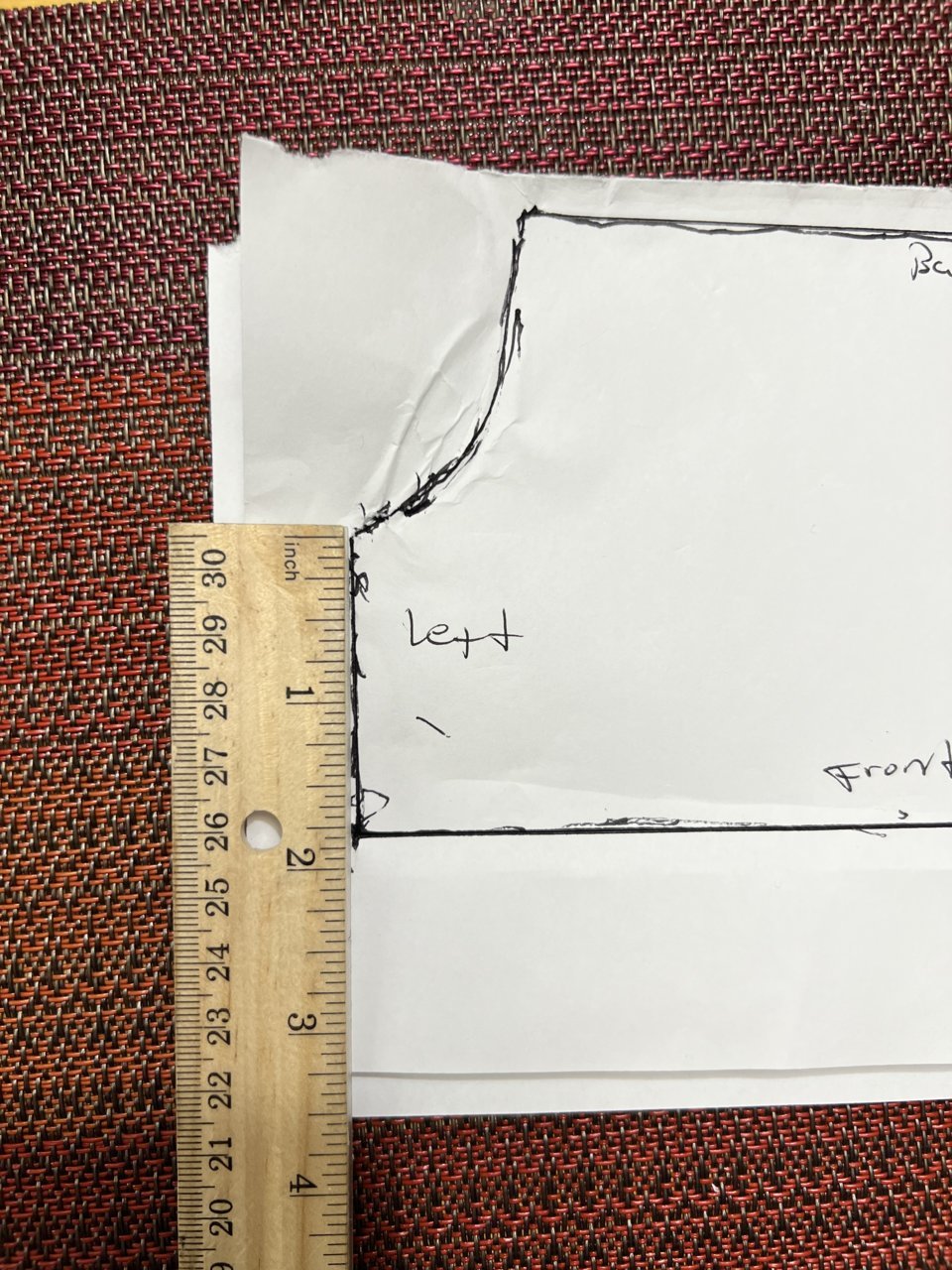

    That would be awesome. I’m going to call tomorrow. Only problem I see with that, is that I’m a brute. Lol. I can use tools, fix a computer.. but designing something would suck like my drawings.. but I’m going to check what detail they would require.

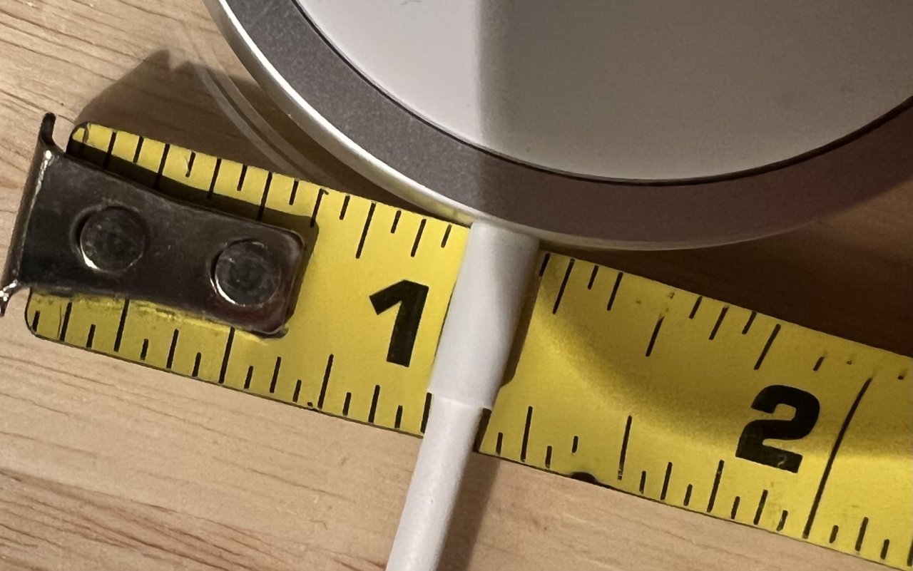

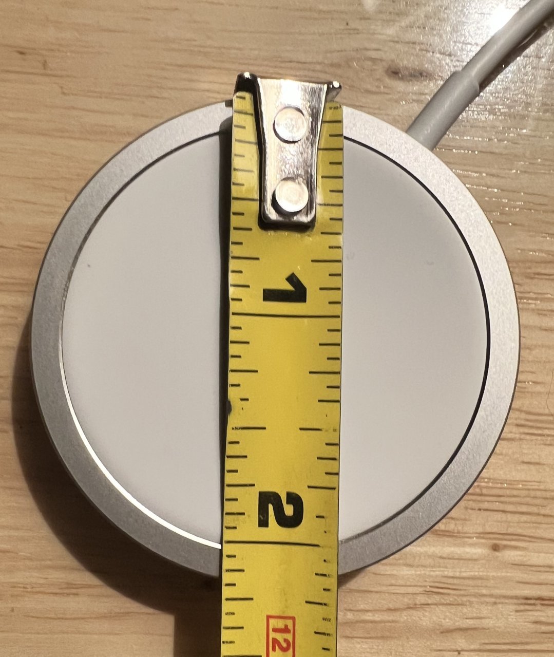

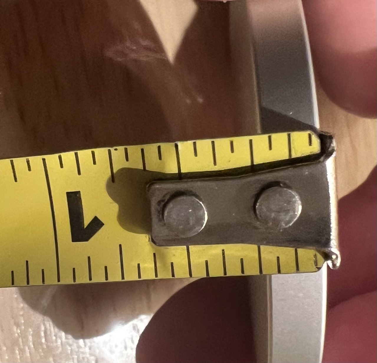

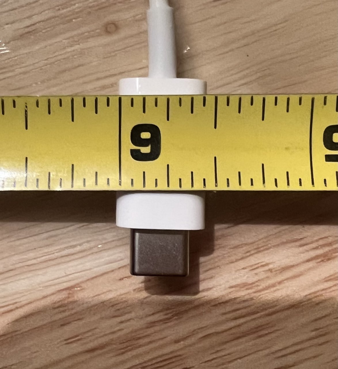

    What is the diameter and thickness of the magsafe puck? What is the cord diameter?
    With that info I could work up a preliminary design.

    In2Ndo
    In2Ndo [OP] Well-Known Member
    May 22, 2010
    #37630
    366
    California
    MGM 2021 Tacoma TRD OR

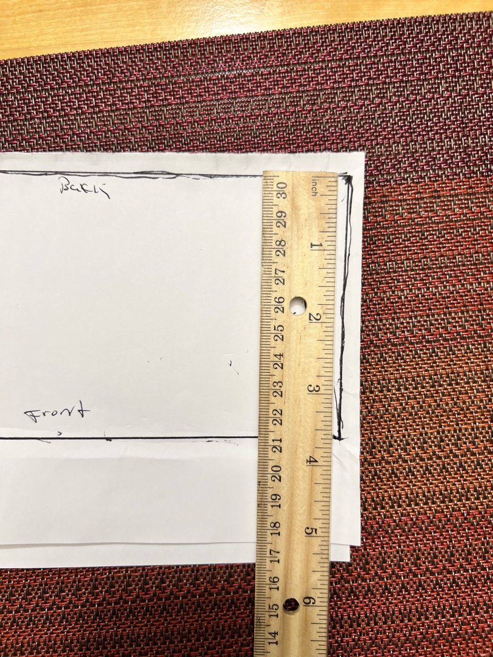

    Does this work ?
    Thanks.
  7. Oct 25, 2022 at 8:11 PM
    Hercanstein
    Hercanstein Well-Known Member
    Jan 2, 2020
    #314990
    1,084
    Bryan
    State of Jefferson
    1999 2.7 SR5 4x4 5MT XC, 2020 3.5 TRD Sport 4x4 6MT AC
    ('99) Offset Aluminium Wheels, 31" BFG All-Terrains, Bushwacker Fender Flares, Window and Hood Wind Deflectors ('20) Stock

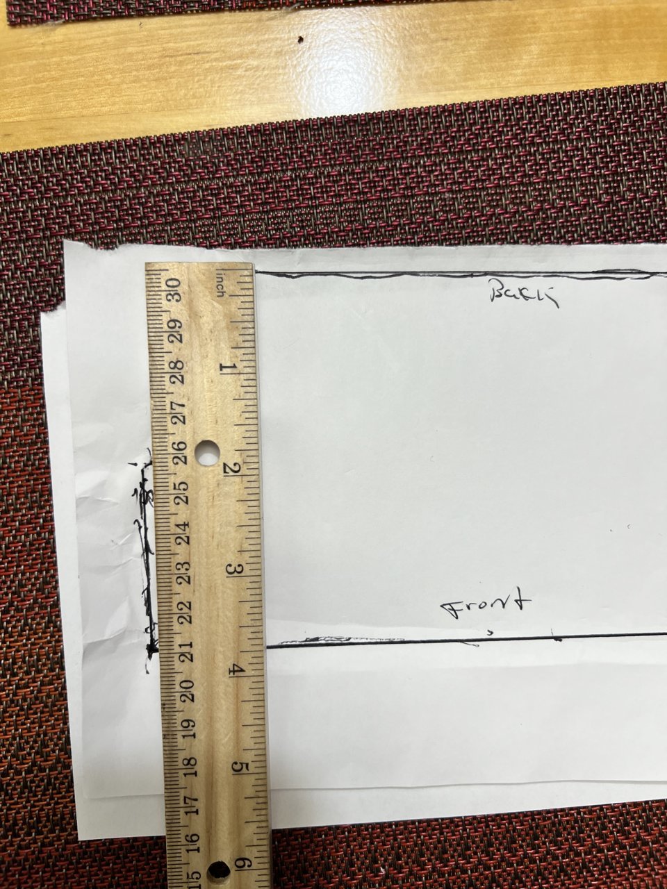

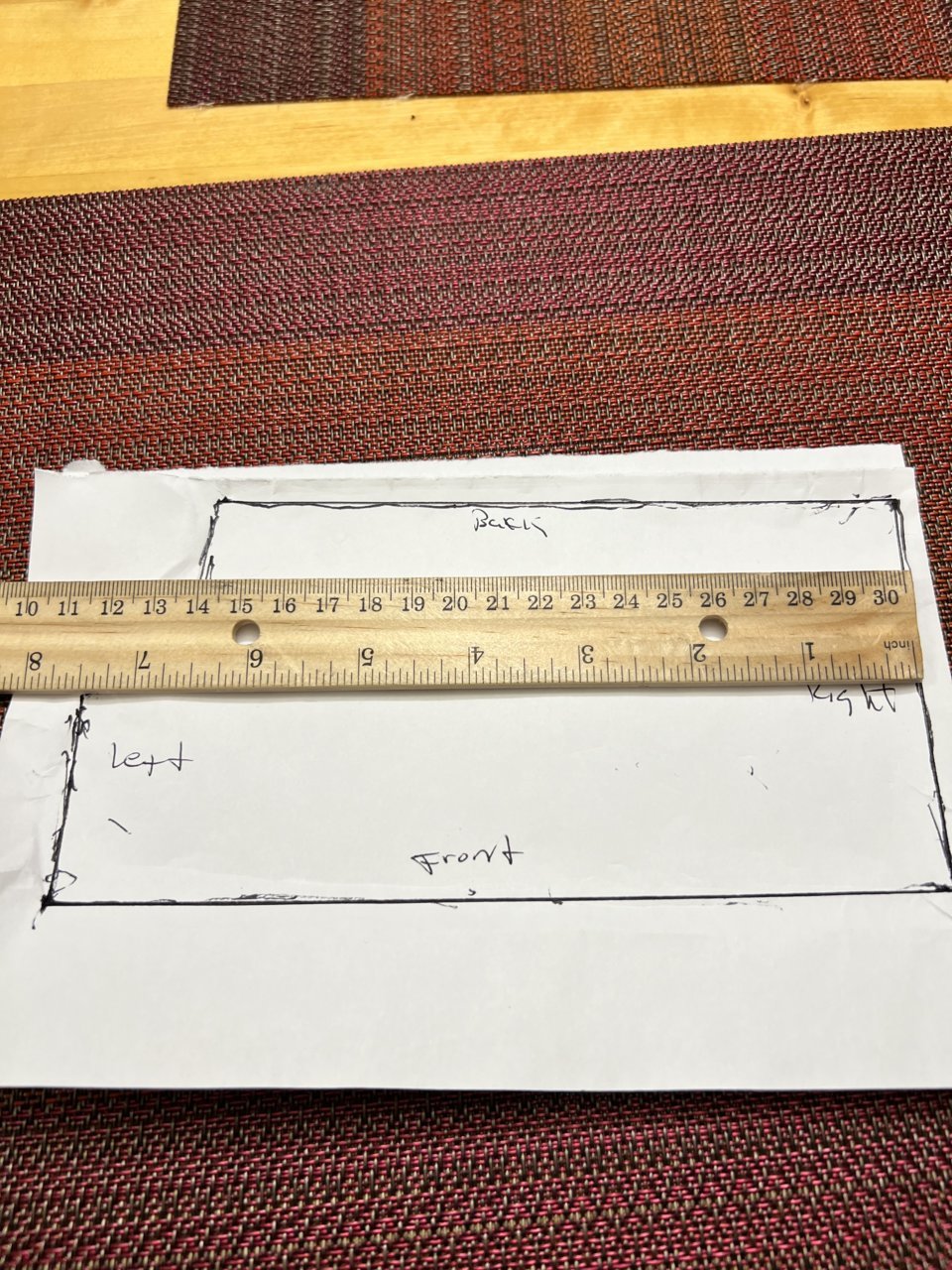

    That looks like I can work with it.

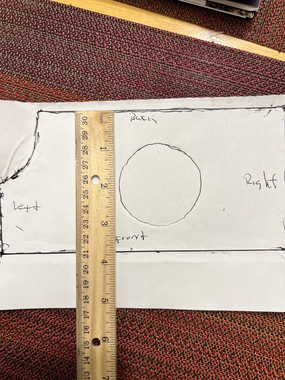

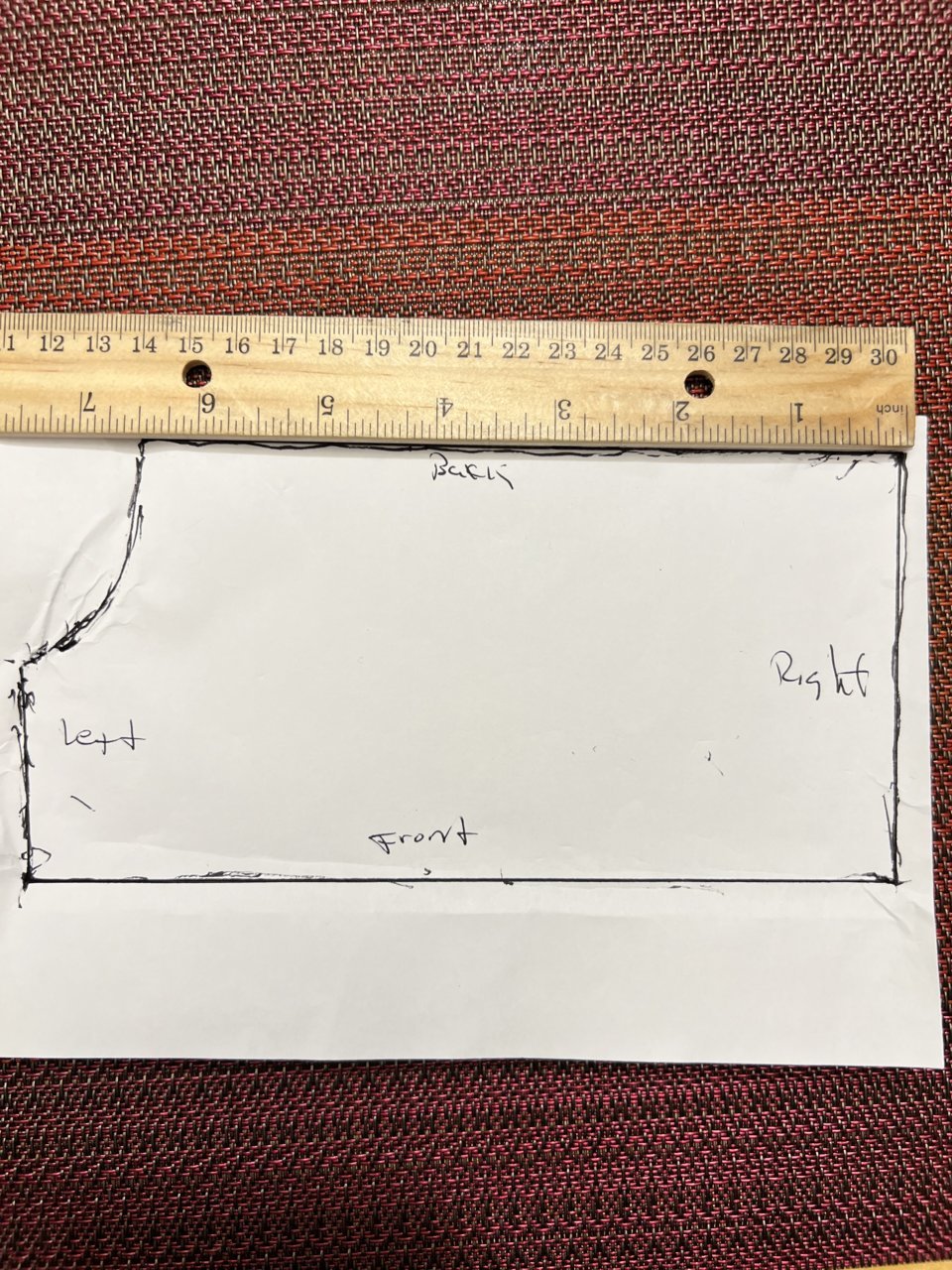

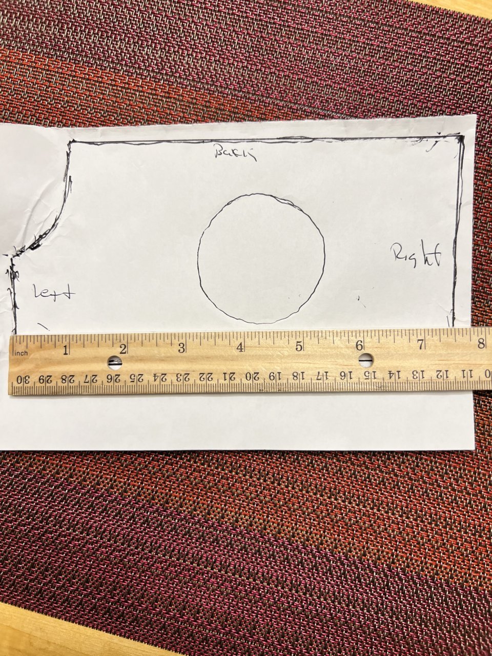

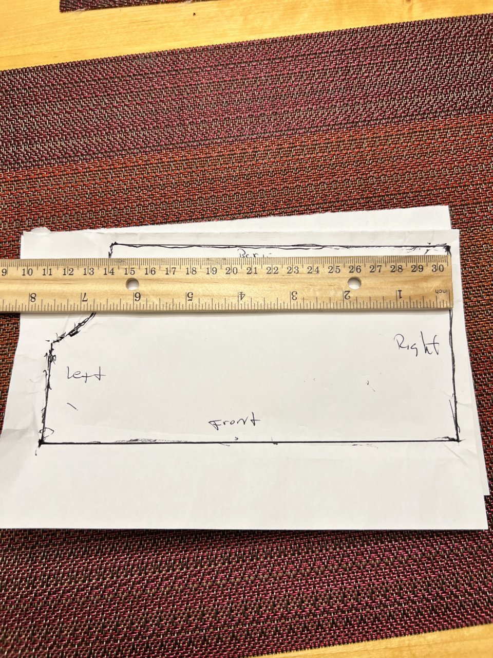

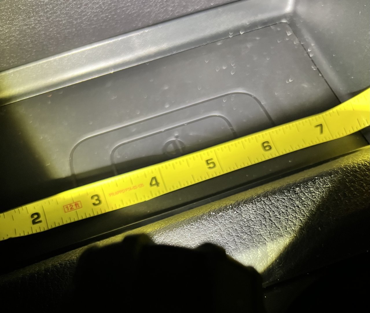

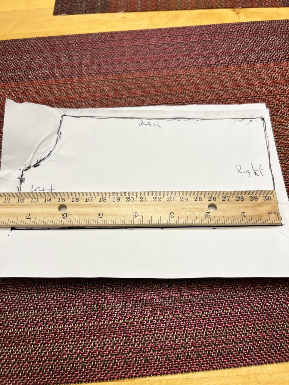

    Do you know the length and width of the qi charging area in the Tacoma?

    May 22, 2010
    #37630
    366
    California
  9. Oct 25, 2022 at 8:59 PM
    Hercanstein
    Jan 2, 2020
    #314990
    1,084
    Bryan
    State of Jefferson
    Nice work, thanks!
    I will try to get something worked up on my lunch break tomorrow. Might have to stay a little late to finish.

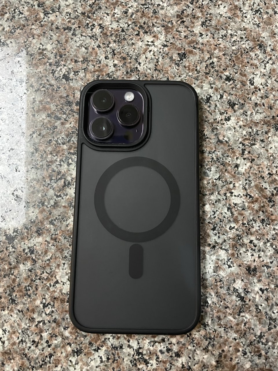

    Does the Magsafe puck hold your phone from sliding around?
    Where would the Magsafe puck need to be located on the adapter panel?
    Should I try to stay below the 1 inch height threshold or go higher and make an indentation for the phone?
    What file type would be most useful for you? .stl?

    It's magnetic, so the puck should hold it from sliding around.

    Does it hold in the center of the phone, or is it offset from the center?

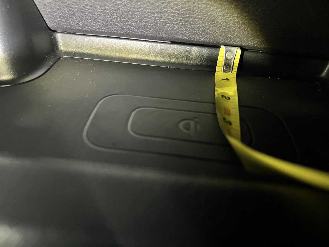

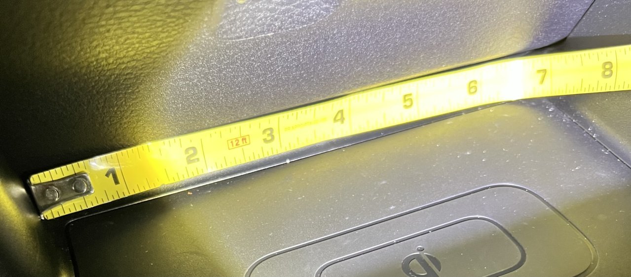

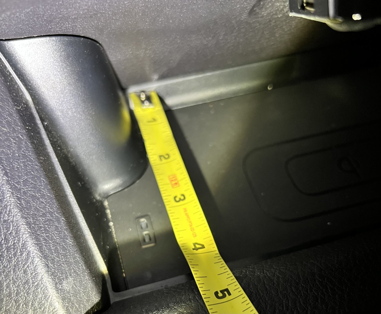

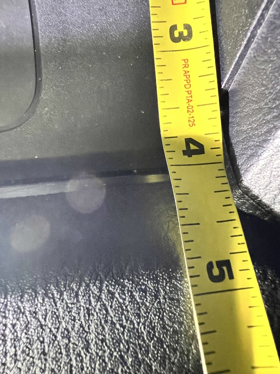

    The MagSafe is magnetic. So the phone won’t move. It should be around the middle. The back of the qi tray is under one inch. One of the tape pictures shows the measurement. And the back wall starts to slant inward from where the tape begins. So I think it needs to be under one inch but keeping the MagSafe from touching the qi tray. Just in case, for safety reasons. And I’ll probably use museum potty to hold the puck in its indentation, so I’ll need a little dept.

    I will design the adapter to be .75" high and the indentation for the puck .25" deep to give you room for adhesive. That will give you .5" clearance from the qi charger. I will probably put a .5" chamfer around the bottom edges to clear the radiused edges. I will leave a cavity in the bottom for extra cable as well.

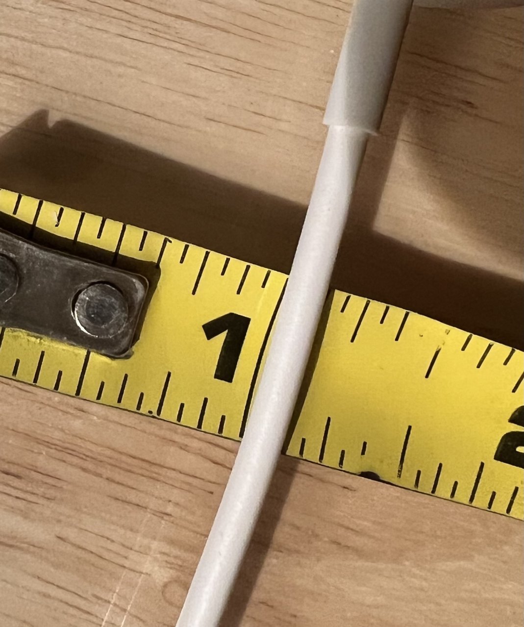

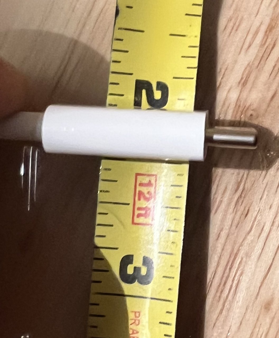

    Got it. Cable end thickness?
    I can't wait to get started on this lil' design!
  18. Oct 25, 2022 at 9:35 PM
    #18
    In2Ndo
    May 22, 2010
    #37630
    366
    California
    About 1/4 inch.
    thank you.
