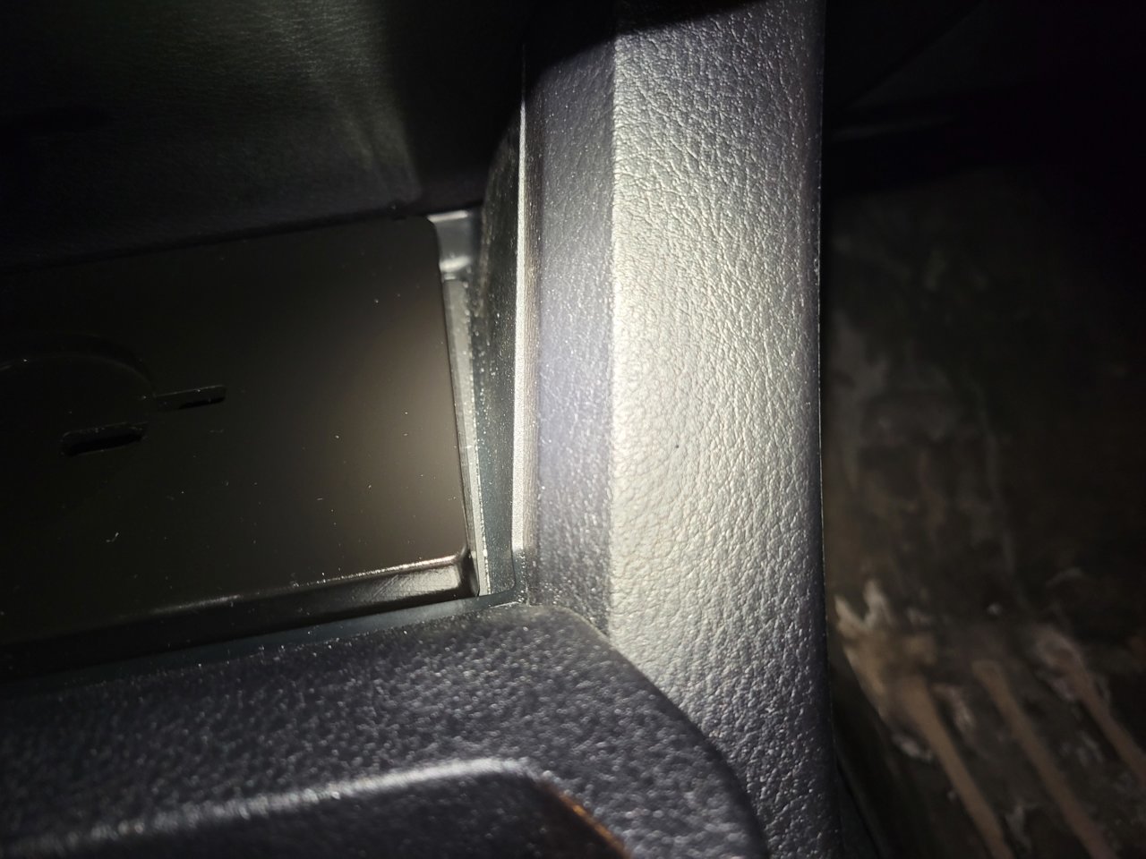

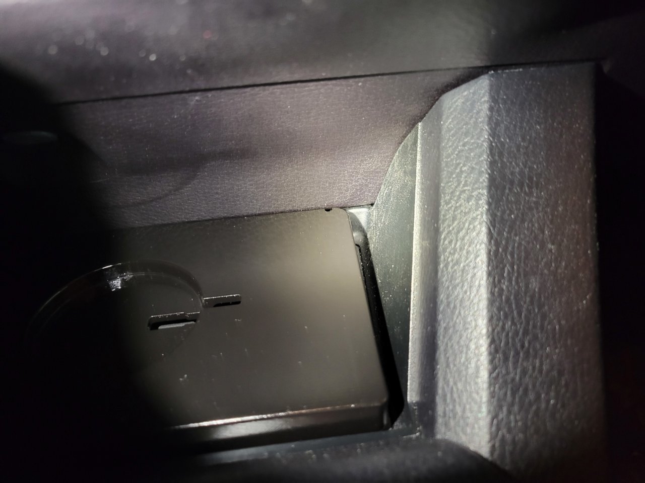

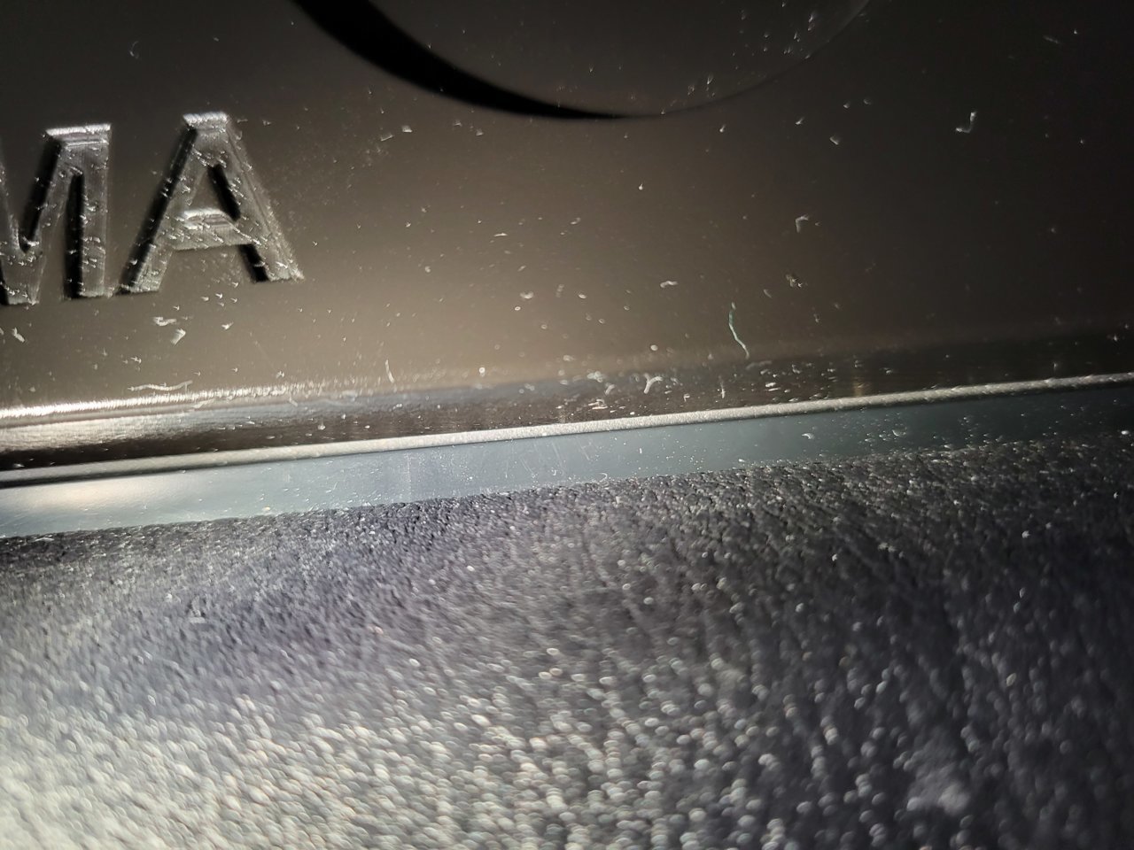

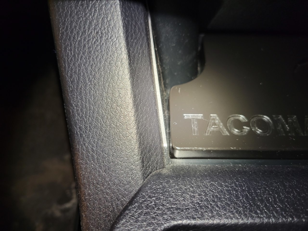

    Ok. I have an explanation. In the back I was hitting on the sloped part of the cubby which the shorter version now clears. I second the make 0.125" deeper.
    Side to side I was centering on the rubber mat (which is currently a perfect fit), but there is some extra clearance on the sides due to the slope in the sides. I hesitantly also endorse the 0.125" wider assessment.
    I will wait to print V5 with the added 0.125" depth and added 0.125" width.
    Pictures showing fitment. It is pressed fully left and fully back when taking the pictures.

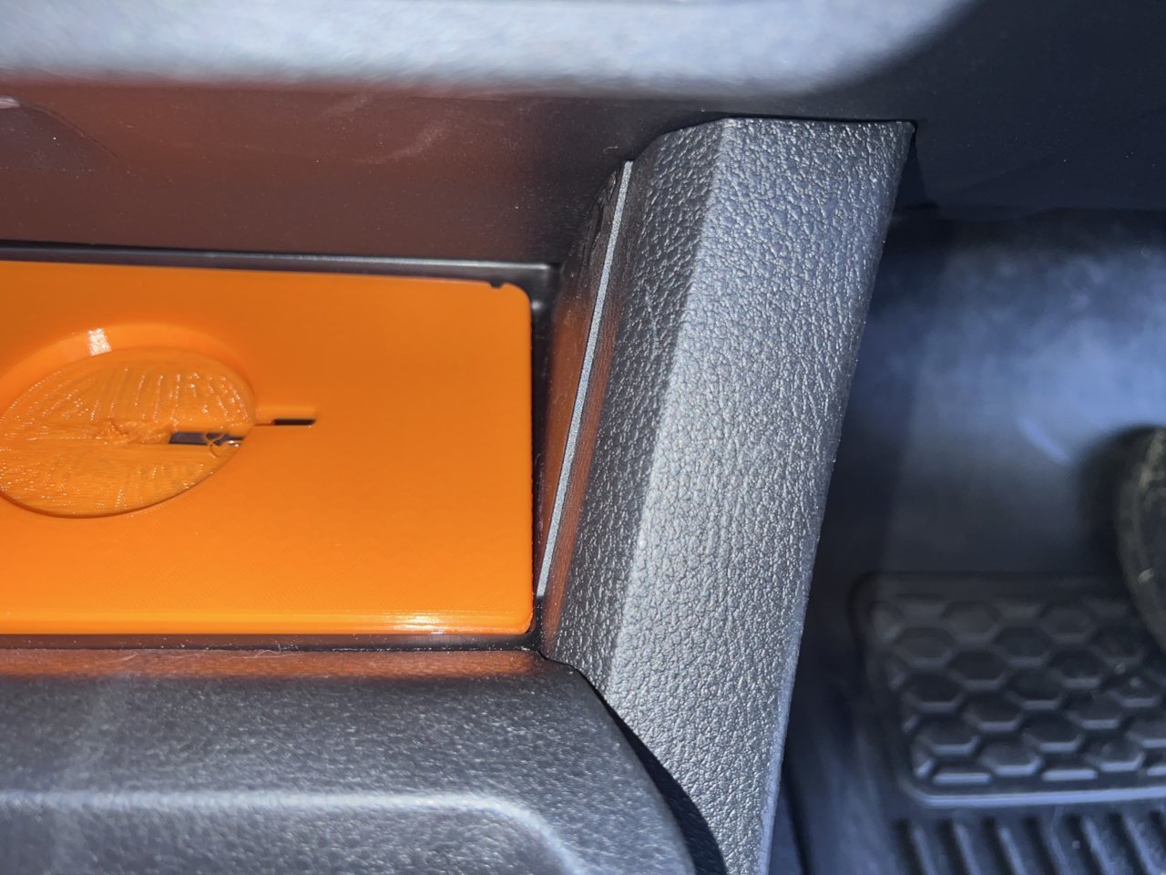

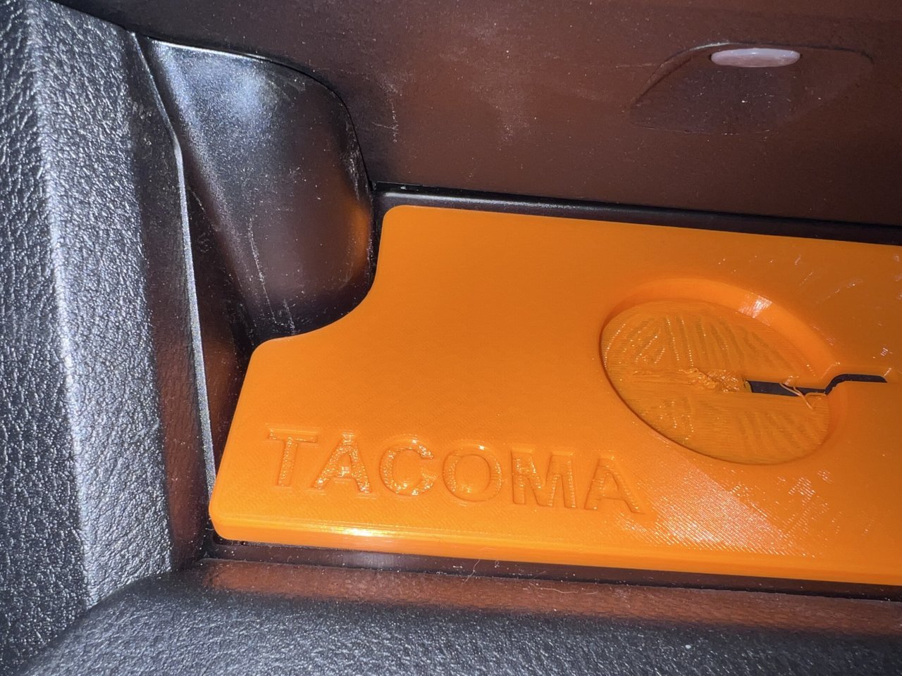

    This is TIGHT!!
    I dig it. One thing I MIGHT change is to taper the “foot” about 5° with the bottom tapering in towards the inside. I don’t think that it’s needed though.
    When I push down on it, there doesn’t seem to be any movement, nor is there any movement front to back or side to side.

    Looks good!
    What do you mean by foot?
    Did you print this upside down?

    I printed the face that you see in the pictures down, didn’t use supports, so that’s why the center of the mag charger has some slight issues.
    by foot, I mean the ring around the edge on the bottom side. That elevates the top face
